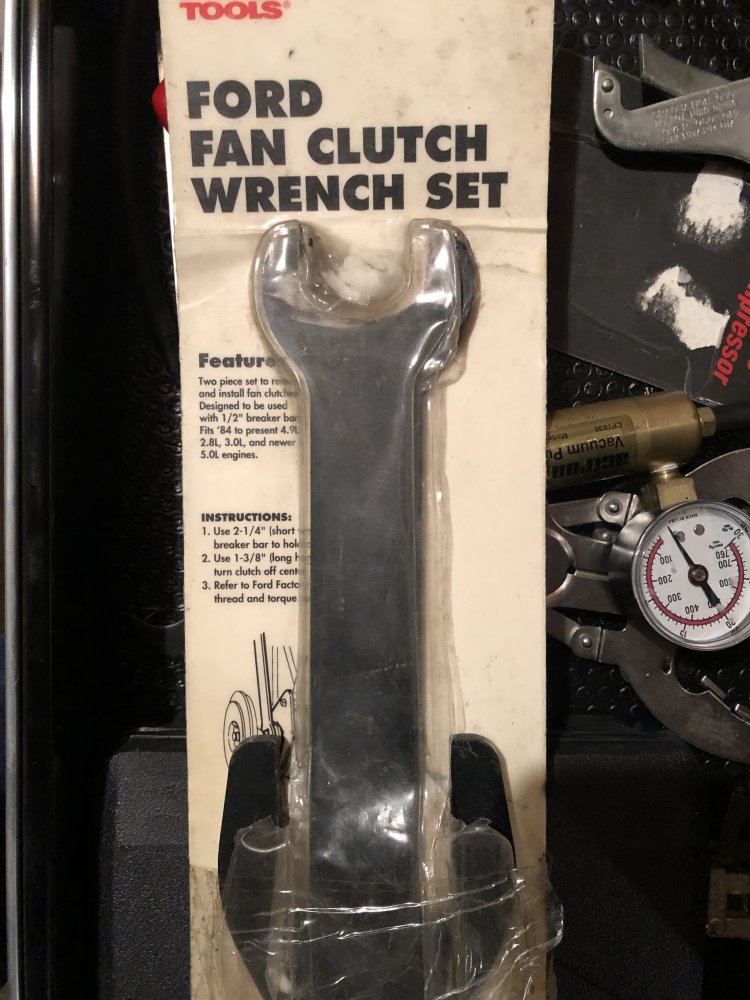

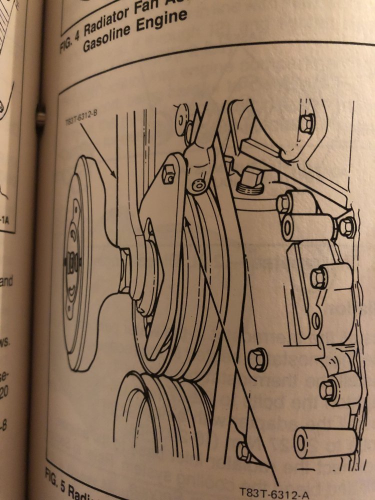

1) it’s left handed threads
2) There are tools made to remove it

I bought a set of those, it was a "loaner" set from AZ, with THREE wrenches in the two wrench set.
I told the clerk about it and he looked in it and pushed it back to me.
Well, I kept it, but now I can't find it :D
I bought the wrenches to remove them. Kinda awkward to use but they have done the job many times.
