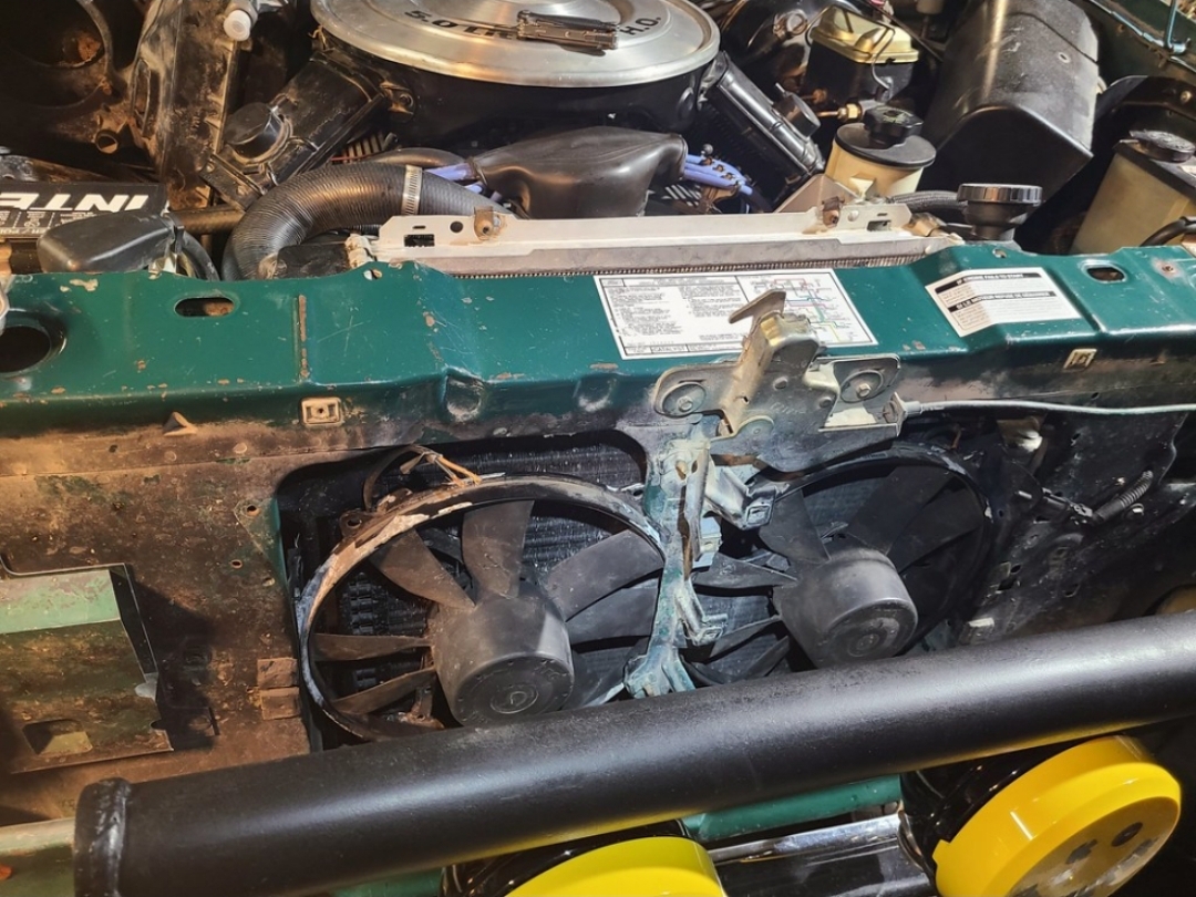

I have a primary puller and two auxiliary pusher fans on mine. If I am running all three, the fans overcool the thermostat housing and prevent it from opening. Took a while to find the problem, but it exists.
A simple piece of tin over the thermostat housing fixes it.
[/QUO. U have 3 Fans on your truck?have a pic of that setup.curious how it looks
I can take one.
It looks like a junkyard puked on it.

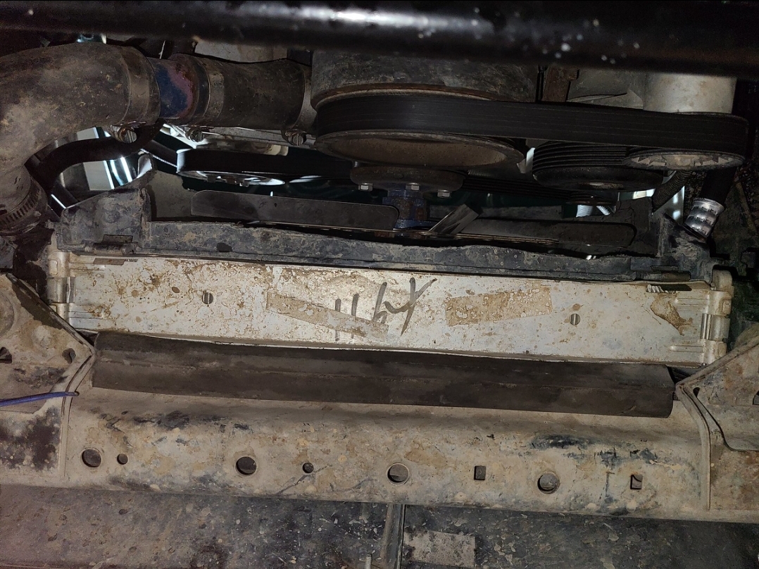

I did the radiator theory very differently though. Bought the smallest one I could find for a 2.9, then ran a high flow thermostat and a bunch of fans. Worked out well. Thinner radiator means easier to push/pull wind through it.
