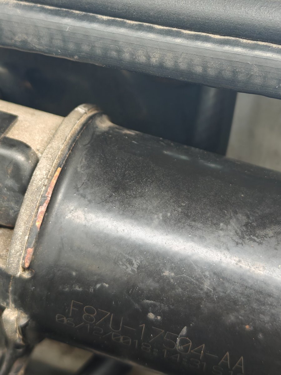

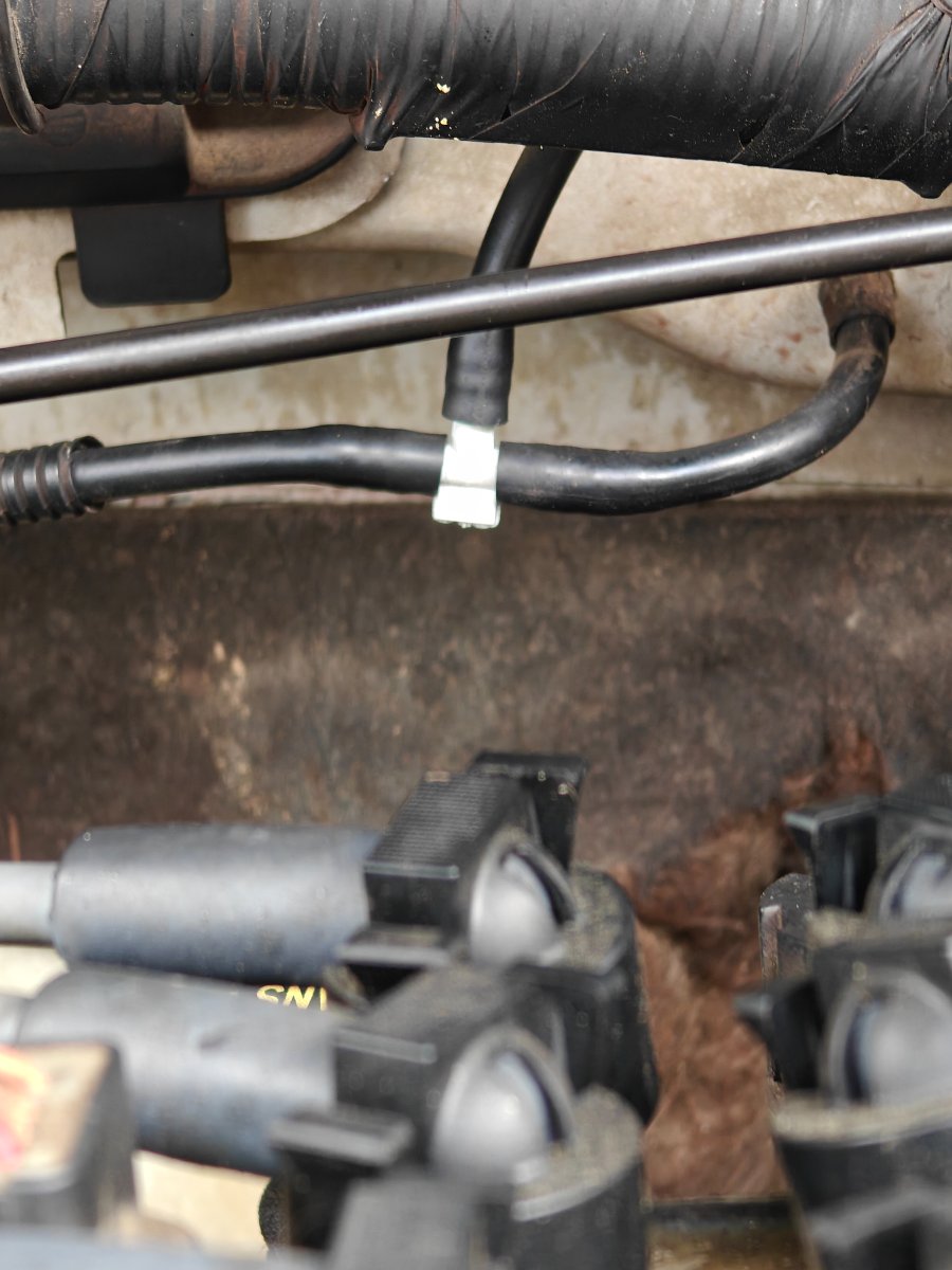

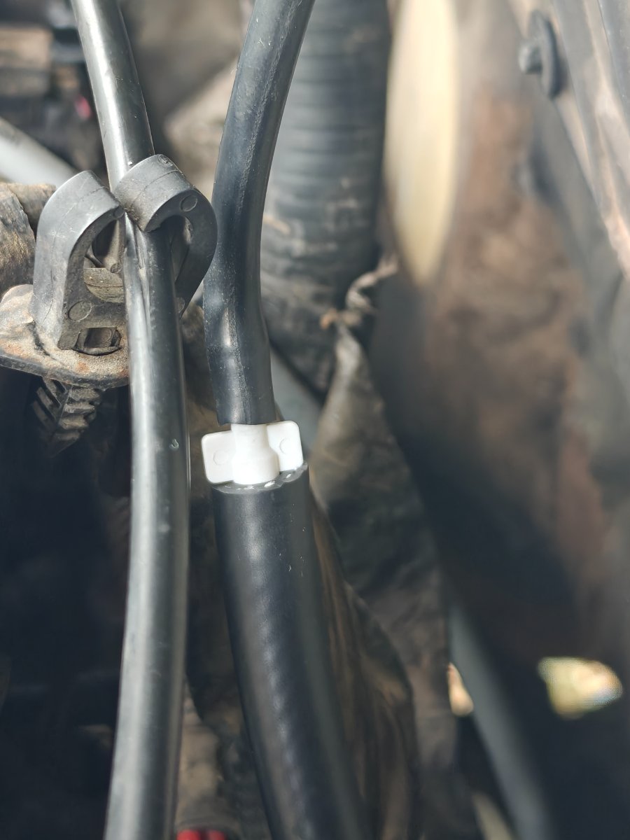

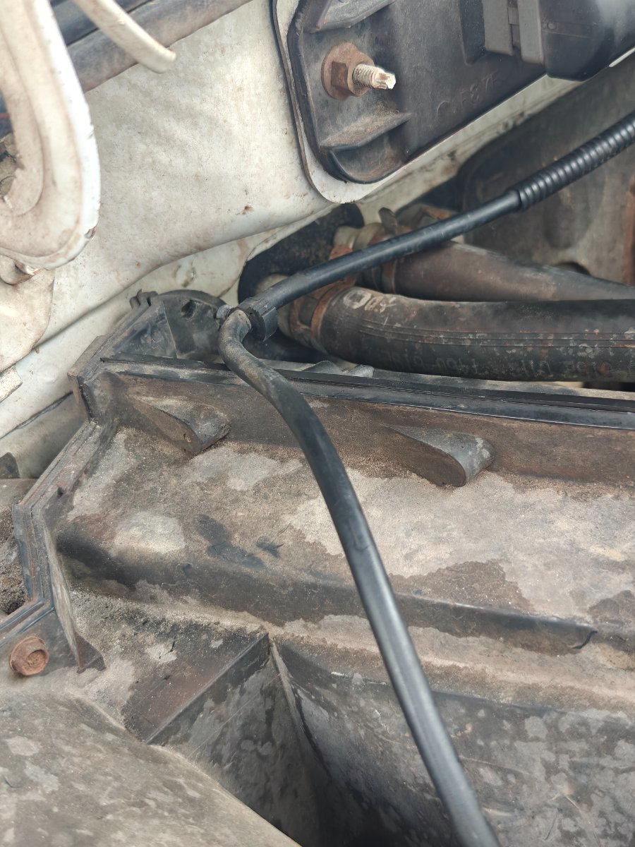

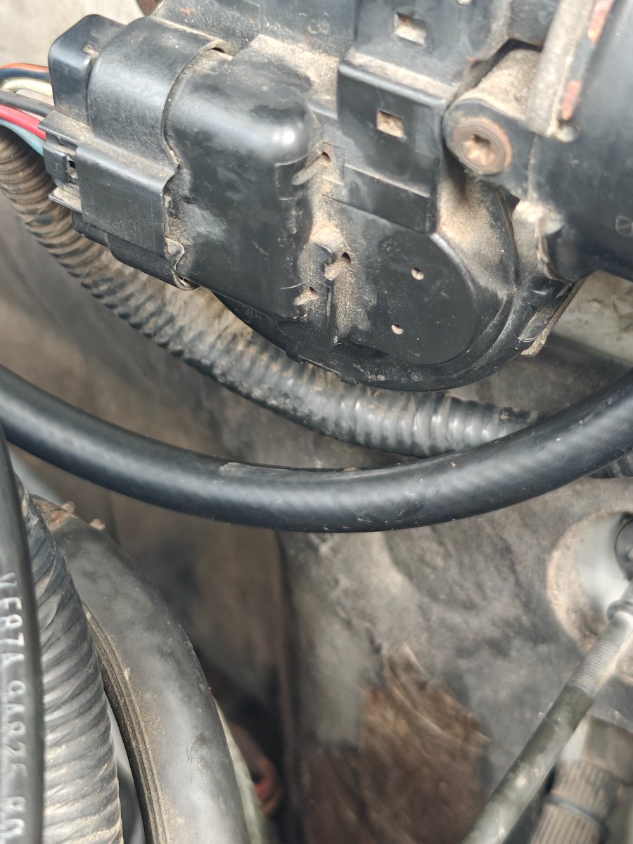

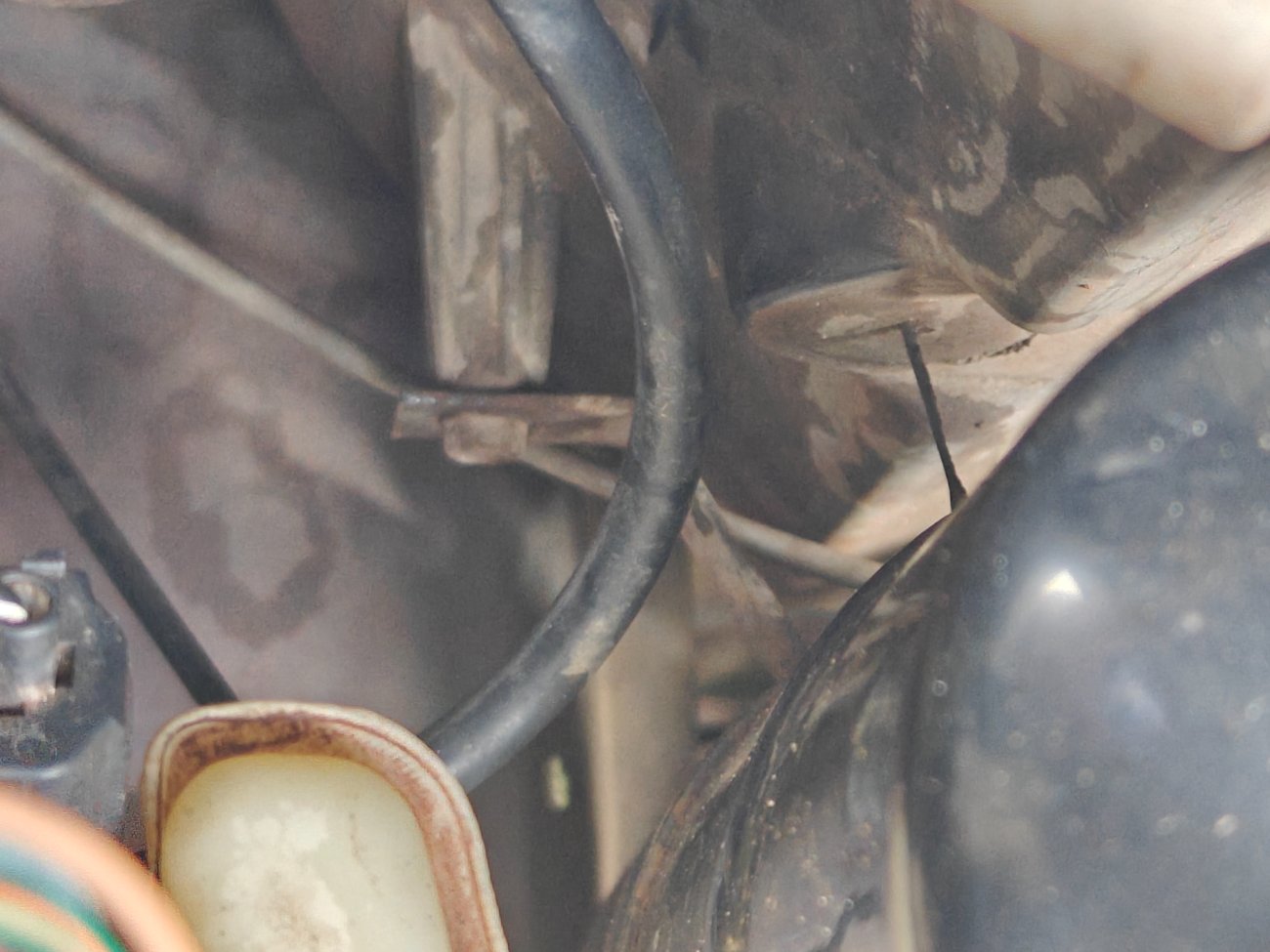

All hoses are factory except for the one I replaced that attaches to the driver side. The nozzle slides right in to fit. I'll have to get someone to help me in order to plug the passenger side while I operate the sprayer. Originally when I bought the truck the driver side worked, but it shot out super high like a jet spray and the passenger side didn't Since trying to fix everything the passenger side works and driver side doesn't. I'll take some pics and upload them of the hoses and such shortly.
As you can see the driver side nozzle hose is much larger than every other hose I guess due to the size of the coupling on the nozzle that it attaches to.

Downsizing the driver side hose isn't going to work or it won't connect to the nozzle. The whole hose system is basically stock except for the broken couplers I had to replace and just replaced the big hose on right side for sh*ts and giggles hoping that would help.
Edit: Plugged the passenger side, made no difference to driver side, still just kinda dribbles out.
