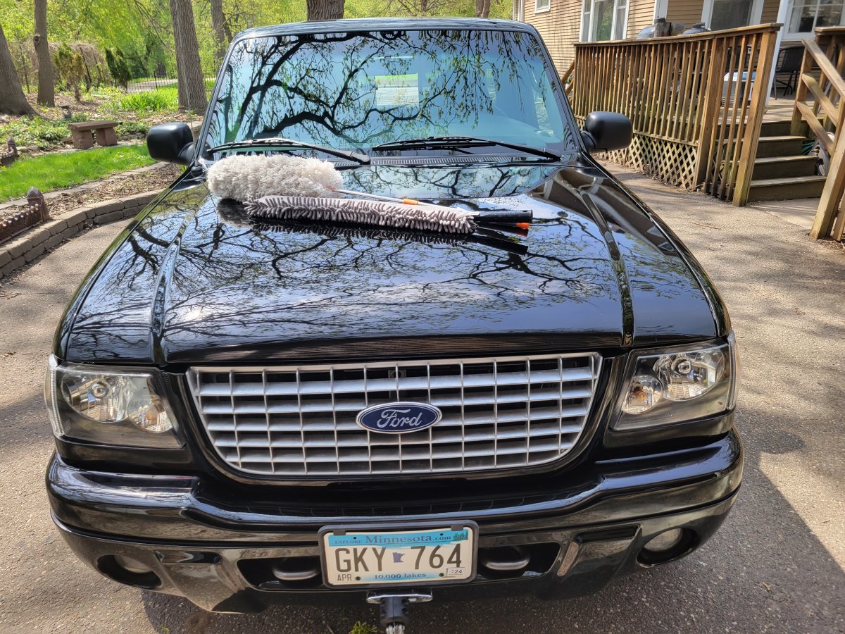

Okay now. Show us your clean truck!
  • Wash Your Truck
Very well, Eric. Just show us your dirty truck.
That wasn't my point. Mine isn't really too bad right now, on the outside.
Wash Your Truck
Not bad! Who wants to wash it?
I was trying to get Rusty to detail it. Actually, if I want it detailed properly, I would probably ask @JohnnyO to do it.

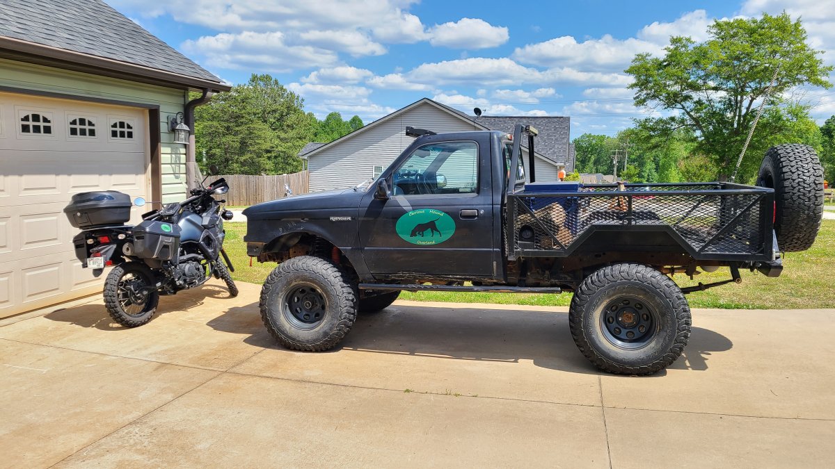

Only wash my ranger ever sees :ROFLMAO:
Seriously...good tips though. But if i washed mine i probably end up with a bare frame afterwards.

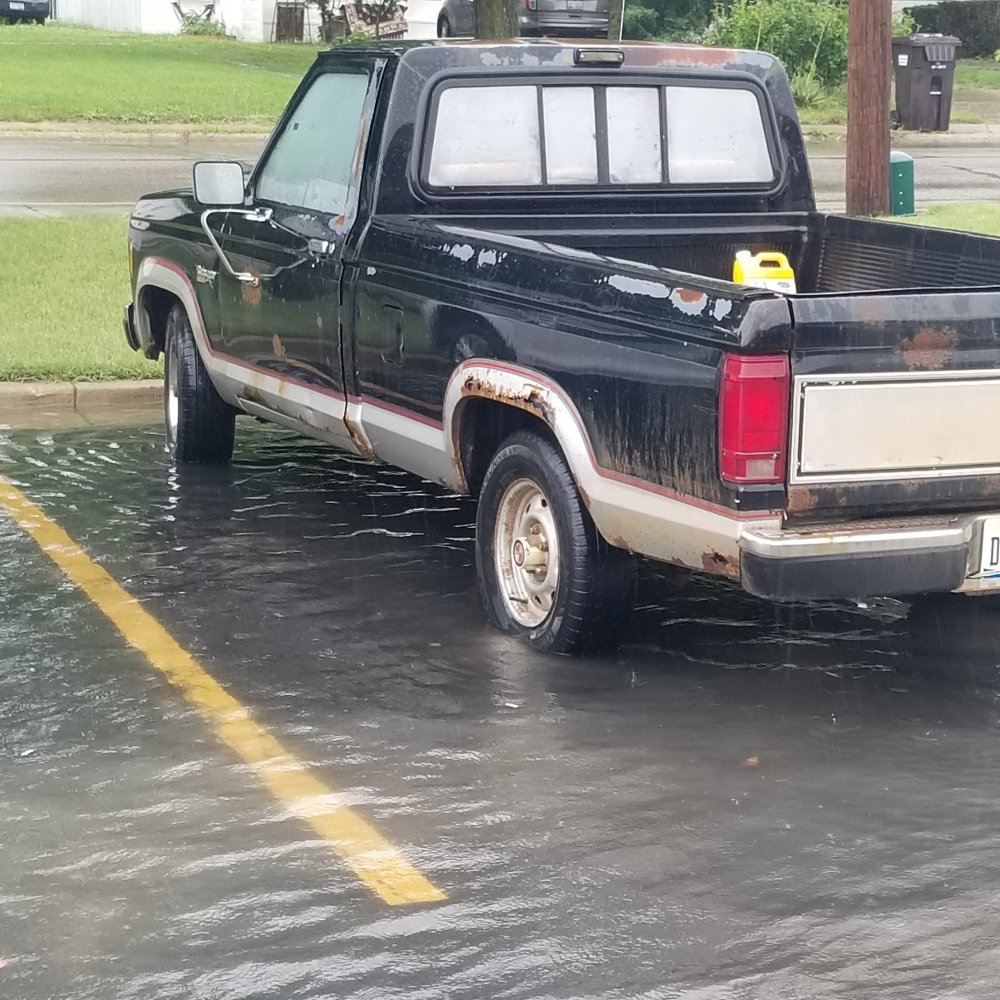

Man, that's a near spittin image of my 87/88 whatever it was :)
Does yours have a 1 1/2 X 1 1/2 steel angle from the drivers side front side rail holding up the left front body? :D
