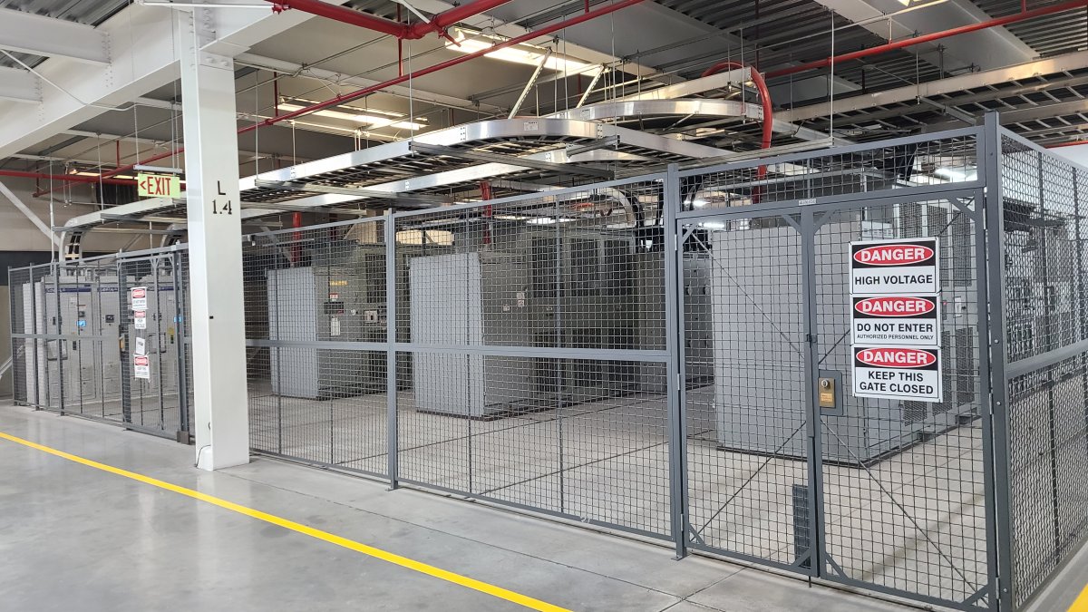

Where that plays a part is in large manufacturing plants and really big commercial buildings. Often measures arevtaken to mitigate it within the facility. In the BMW plant where I work, we had an issue with it. Due to the design of the electrical distribution system in the plant, harmonics in the body shop, where hundreds of welders are operating all at the same time, was destroying variable speed motor drives in the paint shop, where I work. Almost 2 years ago, we finally installed some large filters in the paint shop to clean up our power. It has been a successful project.

Interesting what did they use for the line filters? And I think that one guy is on to something with the UPS idea which is unlimited power supply if Im not wrong?

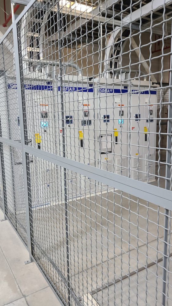

I don't have any details. Thats all handled by facilities. Here is a picture of half of them. I don't have access inside the substation cage. This is the power substation for one paint shop.
