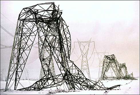

When my parents built the house I grew up in my father bought a generator that would run only the essentials.. just in case. My mother thought it was silly to spend all that money on a generator that wouldn't run the whole house... but pa stood firm on his belief that "its fine".
Well.... it WAS fine.... until the ice storm of '98. We didn't have power for 2+ weeks.
We ended up keeping our food outside, so the fridge could be unplugged and pa could watch the massive power hungry 90s era big screen TV lol.
