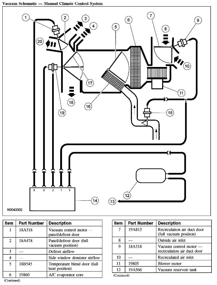

Hi I have a 2007 4.0 sohc fx4. I am trying to find a diagram for the vacuum system. I can't find it anywhere. Can anybody help me out. Please and thanks you

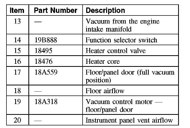

Vacuum system
Thanks for the diagram franklin2.
Do you have an underhood vacuum hose diagram you could also post?
Can't find one. Isn't there a diagram under the hood on the radiator support or stuck to the underside of the hood?
