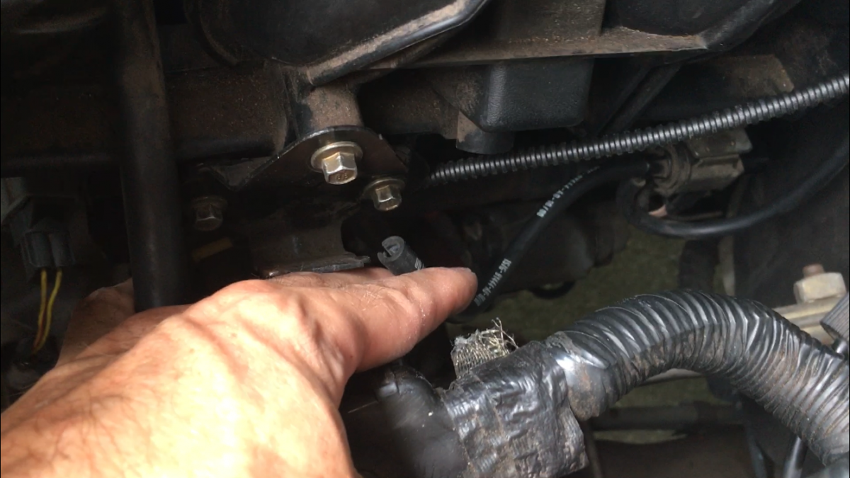

Hello, I’ve got a 2001 B2300. It’s idling rough and almost dyeing so I’ve been replacing parts. I just replaced the PCV valve and while I was doing that, I noticed this vacuum hose hanging out. Can someone please tell/show me where it is supposed to be plugged into?

Whereabouts is that in the engine bay? I'm not familiar with the 4 cylinders
Hey, thanks for the reply Colin. I think I figured it out. I found a spot in the bottom of the manifold. Unfortunately, it didn’t do anything for my idle and almost stalling when I’m at a red light. I’m continuing down the list of things to replace.
