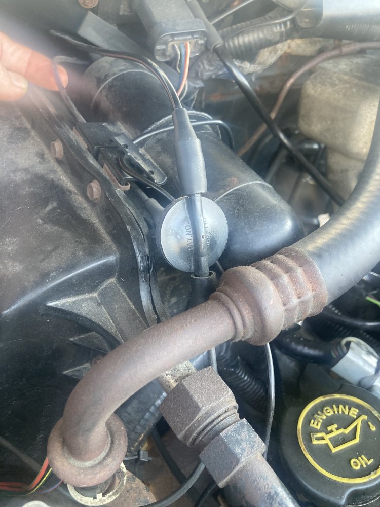

The way my reservoir "section" is currently hooked up.... there's a thin hose coming from the plenum multi connector vacuum point thing on drivers side (which is fed by the master vacuum unit), and this thin hose goes all the way over to the passenger side and hits the center/bottom connection of a T shaped flying saucer device which is pictured below. Then one upper "side" feeds the reservoir, and the other upper "side" feeds a thin hose that goes down to the vacuum motor underneath air intake which controls the warmup flap thing. Anyways, back to the T-shaped flying saucer.... I take this to be some kind of check valve, but i've not found any explanation as to how the design of this particular check valve functions. I also haven't found a single check valve on the interwebs for a ford ranger that is designed like this one, which is surprising. So, i can't confirm that it's hooked up correctly. It has 3889710 stamped on it. Is its center/bottom supposed to be fed from the master vacuum? And the two sides to the above mentioned destinations? In the picture you can see my finger holding the line that feeds the center of it, and this is the line coming from master vacuum. You can also sorta see the line coming from the side of the flying saucer that feeds the back of the reservoir, and you can see the line from other side that goes down into the engine bay to the vacuum motor under air intake.

The flying saucer thing is a check valve. It lets flow go from the reservoir to the plenum, but does not let flow go from the plenum to the reservoir. Since this is vacuum, you have to think backwards. The air flows from the reservoir to the engine as the engine is sucking the reservoir down to a vacuum.
When the engine starts pulling a hill, the vacuum in the engine goes to zero. So the air or zero vacuum would start flowing from the engine to the reservoir if the check was not there. This whole system is to stabilize the vacuum for the vacuum operation of the HVAC and other components. For example if you did not have the reservoir and the check, when you started pulling a hill the air from the vents would switch to defrost. As you get over the hill and close the throttle, the vacuum would come back and the air would switch back from the defrost to whatever setting you had it in before.
If you want to check the operation of the check, you should be able to suck through it one way, but not the other.

Thanks! I understand this, but don’t quite get how the components and hookups are meant to be in my truck. There are 3 connections to the check valve. Does it sound like mine are connected properly? It goes from plenum to center of check, then one side of check goes to reservoir and other side of check goes down to the little vac motor (for intake hot air during warmup).

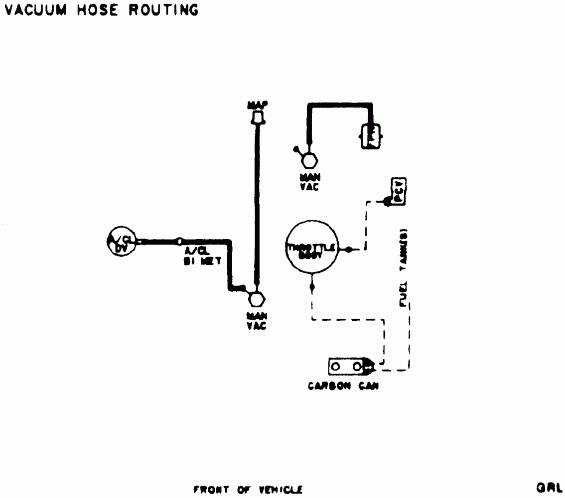

I re-read your post a little more closely, and found the vacuum diagram for a 1989 2.9 v6. What you have there is not in the diagram and doesn't sound correct if that is the year you are working on. I will attach the diagram I found. There is no 3 port valve thing in the diagram for the heat door on the air snorkel.
"Man" is manifold vacuum.
"AC/BIMET" is Air cleaner Bi-metal and this is the temp sensor located in the air tract somewhere. This temp sensor is what regulates the vacuum to the "A/CL DV" which is the Air Cleaner diverter.
P.S. I looked at the picture a little more, that stuff in the picture may have to do with the HVAC system vacuum, which is not shown the the diagram I attached. But it certainly sounds like things are a little mixed up under the hood. I don't have a HVAC vacuum diagram.

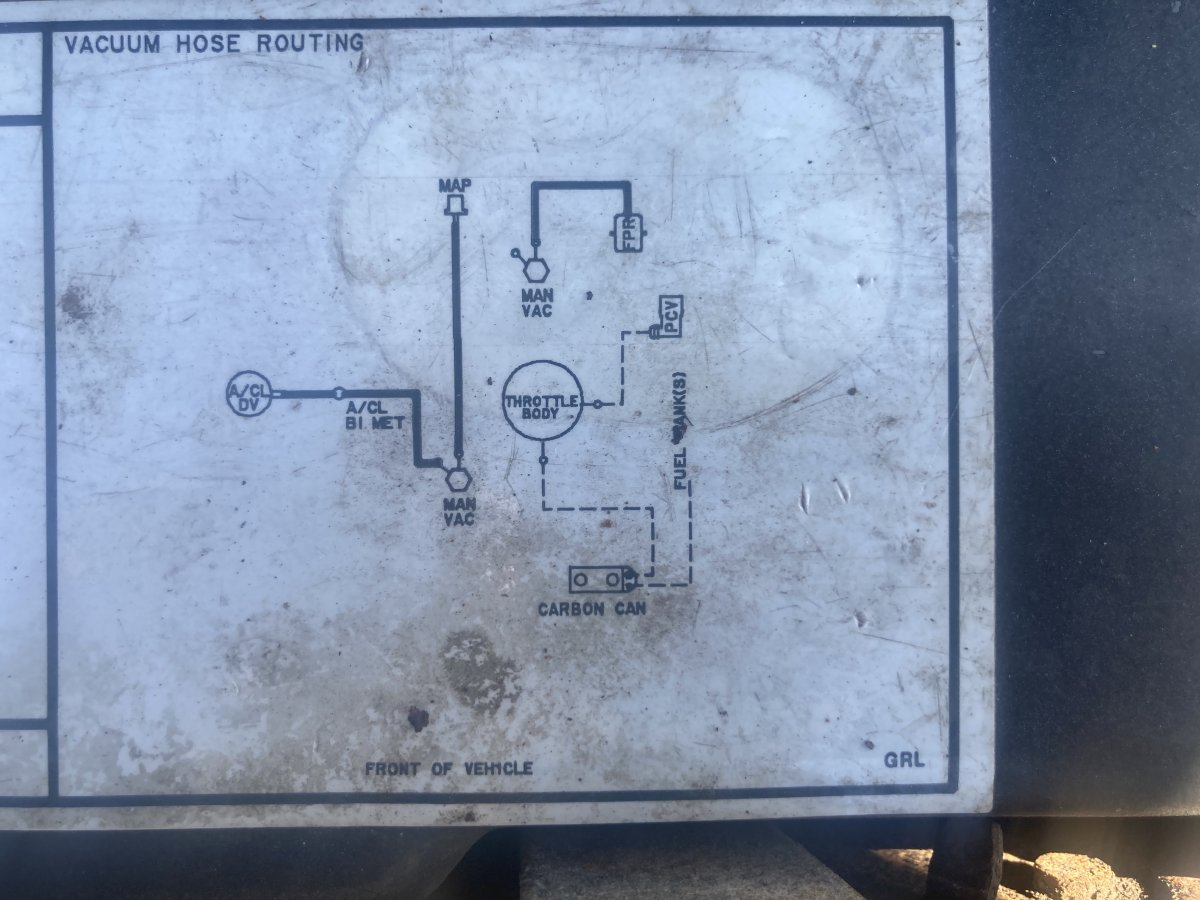

Yeah, attached below is the diagram on my actual truck which matches the one you found.
And yeah it’s been a little weird to figure out what this check valve situation is, since it’s not at all represented in the diagram. There also is zero HVAC connection to my vacuum stuff. But, that’s not drawn on diagram anyways.
So the only thing I can come up with is that the sole purpose of the check valve is to retain vacuum for the air diveter since it’s a vacuum motor, so that it can still run when there’s no vacuum in engine. That’s the way it seems to be hooked up. But I don’t see what the purpose of that is. So it’s a mystery still.
Currently I have the whole diverter situation blocked off… there is a line from plenum that goes to the bimetal, which I plugged at the plenum. There is also a line that goes from plenum over to the check valve in question, and I plugged that spot at plenum too. I am rolling like that for the time being. I’ll worry about the warmup air temp at some layer date when I have more of this figured out!
