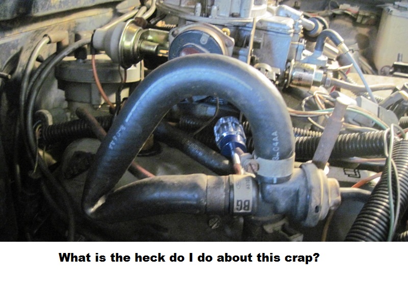

Now its different. Now it starts, runs at a really high RPM for 5 seconds, and then just cuts off. It will not even idle on its own, even when the engine is warm. If I hit the gas repeatedly, like I had to before the rebuild, then I can keep it going. So, I started looking around, and found some vacuum hookups that have no line to them. I've searched on this site, other sites, and in the Haynes service manual, and still cannot find out what they go to, if anything, or if they just simply need to be plugged up.

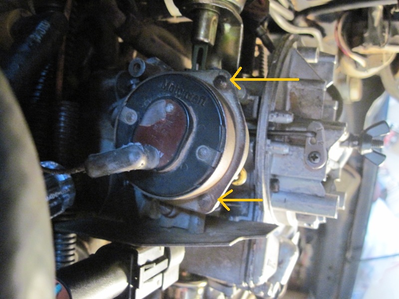

Also, I'm trying to set up the choke and the fast idle, as I have a feeling that this is a huge part of my issue(s). The choke is pre-set from the factory, and I cannot adjust it, like all of the manuals say that I'm supposed to. They say that I should take out the screws and adjust it, but there are no screws. The choke has been pressed in, and not screwed in, from the factory, as you can see from the picture. The fast idle adjustment is also different from the other diagrams. There is only one notch in the fast idle adjustment, not multiple ones like shown in this rebuild instruction manual: (http://www.ifsja.org/forums/vb/showthread.php?p=941955) ...

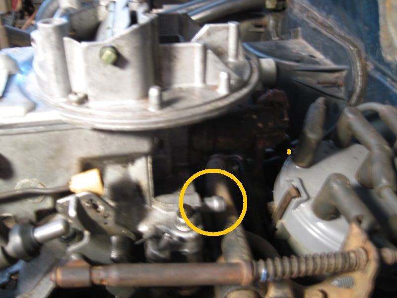

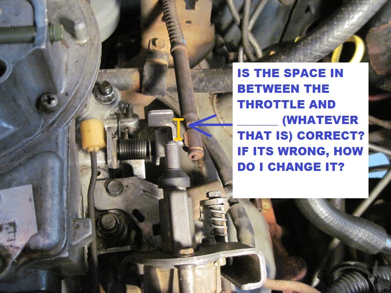

Lastly, there is a gap in between the throttle and some sensor. What is that sensor thing that is there, and is there supposed to be a gap?

1. what goes on the two vacuum hookups that I cant find any hoses for.
2. What to do about the choke and the fast idle.

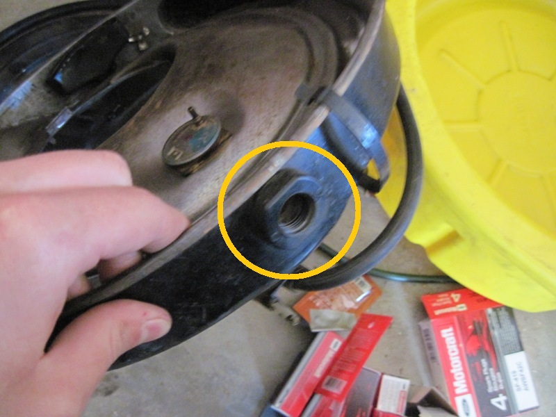

4. There's a threaded hole in the air filter cover that doesn't have anything in it. What is supposed to go there - a sensor of some sort?

That should go to the PCV valve in the passenger side valve cover. If it is going somewhere else, cap that nipple.
Need help troubleshooting carburetor issue(s), & where do these vacuum lines hookup??
Probably for some of your deleted emissions stuff. Mine didn't have that nipple. Cap it.
The first one is a massive vacuum leak and will cause major drivability problems on its own. I don't know exactly what the second nipple pictured does, but it sure wasn't meant to be open like that and may be a second vacuum leak adding to your problems.

On a non emissions era carb that is adjustable, where it is riveted they would have screws to loosen so you can adjust the timing of the choke. You can't adjust the 2.8's, just make sure it gets power with the key and the choke opens as the key is on.

Mine didn't have a threaded port like that. It did have a twist and lock senser towards the front on the passenger side, I supposed for intake air temp. Plug it until you figure out what it does.

That bumps up the idle, mainly when the A/C compressor kicks on I think. I removed mine and it ran the same, kinda cool to take apart too (it has a screw mechanism to move the the finger in and out)

#1 The vacuum nipple on the rear base of the carb is for the PCV valve.
#2 The nipple on the under side of the air horn is for the vent solenoid for the egr
the yellow line http://www.therangerstation.com/tech_library/diagrams/1983vacuumhoseguide.jpg
#3 The screws for the choke thermostat are the stock snap screws take a small chizzle and turn them out a little bit once you screw them out you can get regular screws to replace them for adjusting the choke spring tension.
#4 That hole is for the intake air temp sensor for the computer without it the computer will never work correct.

#6 Is the idle control motor take the idle screw on the side of the carb and turn it out until the engine stalls or the idle motor takes over. The idle screw on the drivers side of the carb is just there so the engine dont stall when you let off the gas until the idle motor takes back over. It is call the anti diesel screw on that carb.

2.) How do I properly set the idle screw and the idle control motor? I’ve read that I can have either the idle screw OR the idle control motor regulate the idle. But I figure they wouldn’t have put the idle control motor AND the idle screw there if they both didn’t have a purpose – so what is the correct balance between the idle screw and the idle control motor when properly setting them? & what is the purpose of the idle control motor? Do I really need it, or can I just disconnect and remove it and just rely on the idle screw?

It could be the choke relay next to the starter solenoid it should put out a pulsing voltage when the computer tells it to. Did you get the choke thermostat loose the rivet looking things are actually break away screws use a small chizel and tap them out until you can grab them and get some screws at the hdwr store of from another carb in the bone yard. Just turn back on the choke spring so it holds the choke all the way open you can address it later. Turn the idle air screws on the base of the carb out three turns from the lightly seated position and then You will need the IAT or ACT sensor that screws into the air filter housing plugged in also. intake air temp or air charge temp same animal without it the computer goes goofy. All it needs is plugged in giving the computer an input as well as all the sensors. Disconnect the battery for 1/2 an hour then start it and see if the idle motor takes comtrol of the idle you cant adjust anything until it is up to temp so get the timing light set up pull the spout and check the timing now you want 10 degrees btdc plug the spout back in and warm it all the way up and then check it again lock it down and check it again. once the timing is set and good unplug the idle motor and adjust the idle air screws for the highest rpm or vacuum you can get plug the idle motor back in and the idle should be around 700 rpm if the idle is high and the motor is not touching the throttle lever back out on the screw on the side of the carb by the throttle cable until the idle motor take over the idle. You dont want that screw touching the throttle lever just real close so when you let off the throttle the engine dont die until the throttle motor takes over the idle. Now turn the engine off and the idle motor plunger will fully extend that is your curb idle unplug the idle motor and start it up you want around 1150 rpm and to adjust it use the screw on the side to move the motor for the proper curb idle adjustment lock it down and plug the idle motor back in and it should control the idle. So first you have to confirm the timing then adjust the idle air screws then the curb idle and then you can mess with the choke just leave the choke all the way open until you get the carb dialed in it is allways the last thing to worry about oh yea dont be afraid to reset the computer especially if you run it without one of the sensors disconnected make sure everything is plugged in before you turn the key on.
