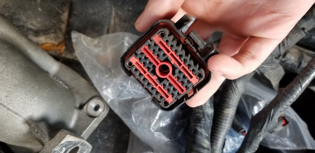

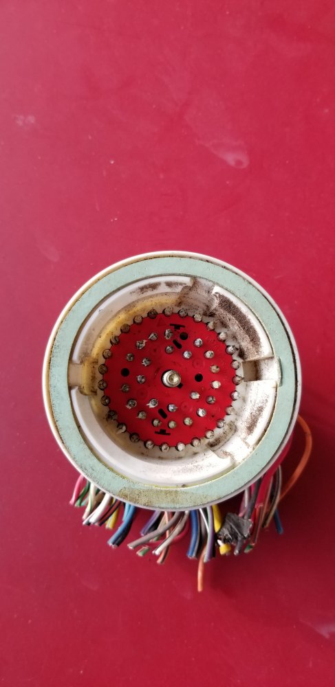

I'm already wrestling with an engineering issue as old as time.. putting a square peg in a round hole. The firewall connector from the 2000 Explorer harness is square, while the connector in my '94 is a circle. The solution I am pursuing is to get another circle connector from the junkyard and then repinning the square connector as the round one.

It's been quite awhile since I've been on this thread but I figured a few things out. I didn't have the full 2000 harness because the gentleman I purchased it from swapped it out of a 2000 ranger. Since the 2000 ranger and 2000 explorer share the same vehicle side of the harness, he didn't include that. In my case because the recepient is a '94, I do need the vehicle side of the harness. So I went to the junkyard and extracted the full vehicle side, including the three firewall connectors.
I finally have the full harness. I still have the connector conversion issue to sort out, but at least I have actual connectors to look at. I have also acquired the wire harness book for the 2000 Explorer so I have official ford documentation to look at.

The most daunting task I have is adapting wiring. If the 92-93 Mustang 5.0 harness uses the barrel style connector instead of the triple square connector setup for the firewall connector and the computer lives next to the driver's fender versus the middle of the engine bay like on a 2000 Explorer I would seriously consider it.
