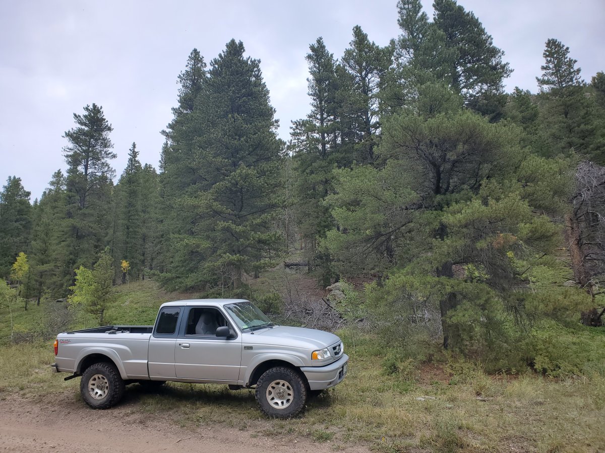

Well, I got the axle nuts installed and had a local shop align it and replace my torsion bars. I would have done the torsion bars myself, but my actual job has been getting busier in the last two weeks and to be honest I was just getting tired of wrenching each night haha! I had new code 1 bars, which hopefully aren't too stiff considering I have the 3.0 and a manual transmission... It certainly looks like the front end sits a lot higher after they were installed, but then again my original torsion bars were 20 years old and definitely sagging (the truck had a noticable lean)... so it might just be that I'm noticing the difference.
Anyway, the 4wd swap is complete! I took it for a shakedown run on the Slaughterhouse Gulch trail, and it performed really well! My goodness, I had no idea how much traction you have in 4wd haha. Even on our decomposing Pike's Peak granite I only had wheelspin in a couple of the gnarlyier spots. The two Torsen diffs seemed to work really well together, and I can't wait to try some of the trails where I've had to turn around before!

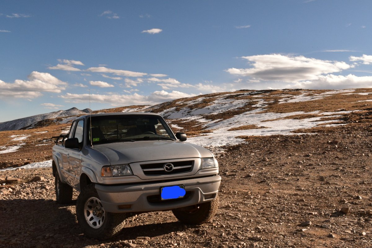

@ericbphoto
I would like to nominate the above photo to next years calender.

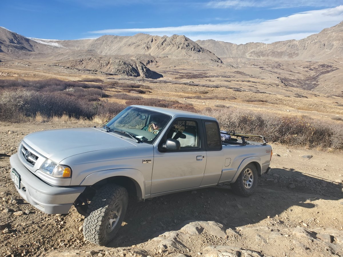

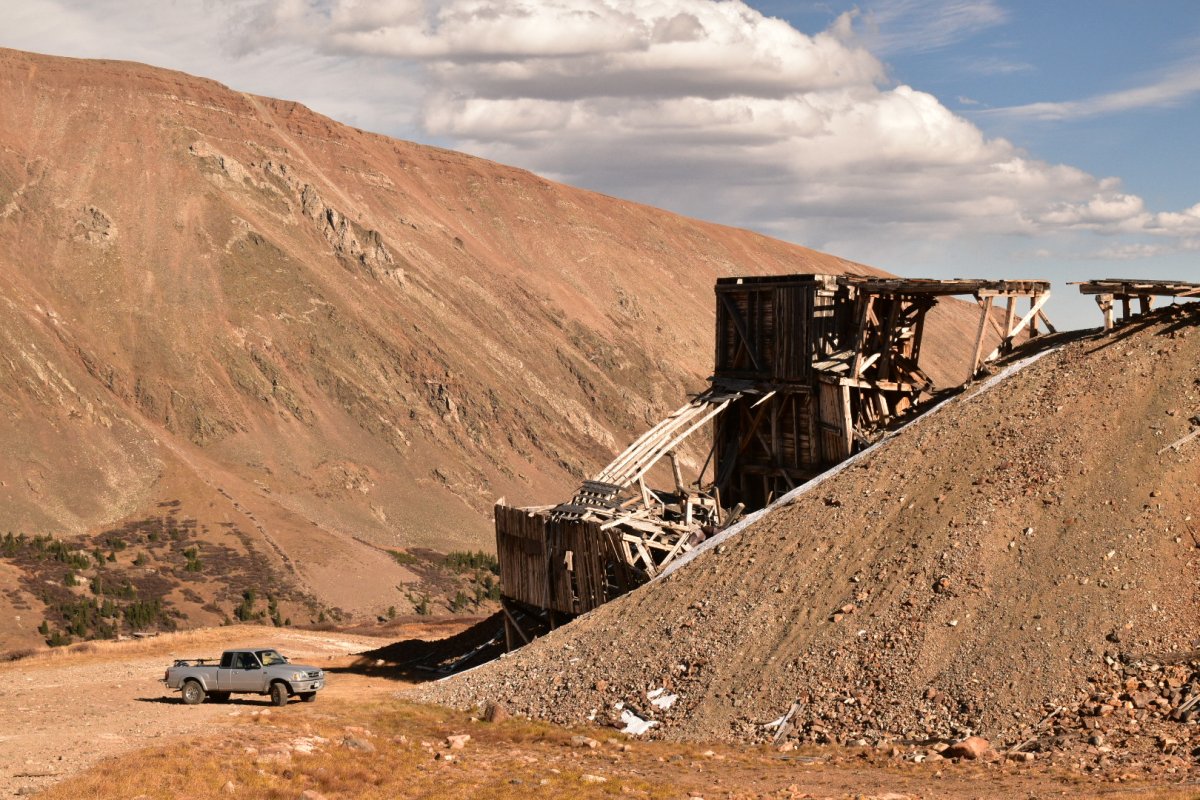

Here are some more pictures for fun. I just took it up Mosquito Pass today:

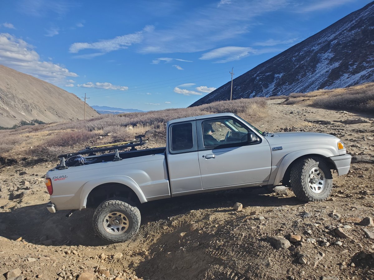

I stopped on this flexy washed out rut section because I wanted a glamour shot, and was pretty sure I'd need to back down and take a different line. Surprisingly there was enough traction to crawl right up though! It's hard to tell, but I imagine the Torsens helped a little.
