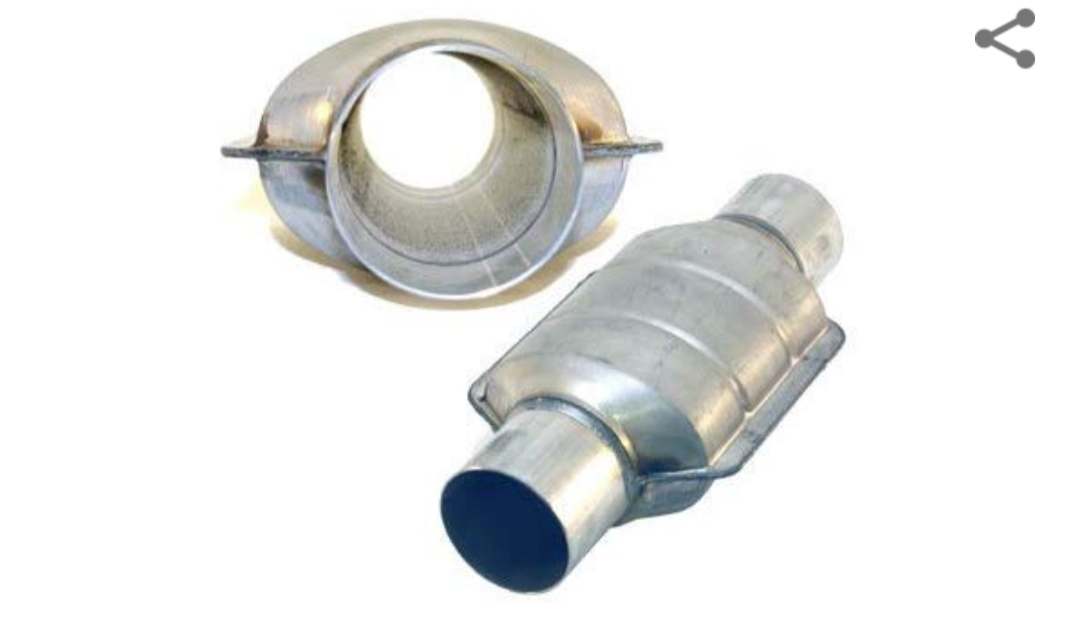

no converters in exhaust? just weld bungs in downpipes?
51197
With bungs in the down pipes
