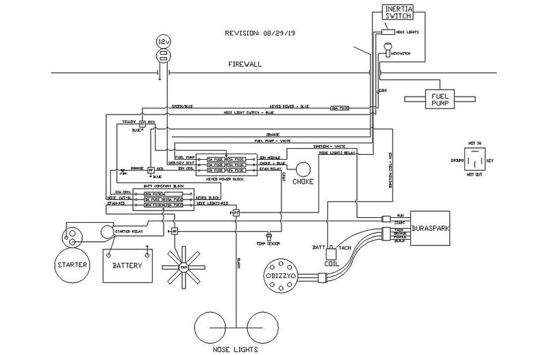

My Ranger originally had something like a 45A alternator, it now has a 130A Explorer alternator. I have added a lot of stuff to it over the years, all of which runs off the battery side of the starter relay.
I will be doubling the number of efans in the future and someday hope to add a winch.
At what point is the factory wiring not going to be enough? What is the best way to go about fixing it? According to the EVTM it T's with one going to the battery and the other going to the fuse panel.

I actually have two fuse panels added. One is constant 12v and one is keyed power.
Right now the only way my added on stuff touches the truck’s factory electrical system is thru the alternator wiring.

I have it all on the passenger fenderwell where all the vacuum stuff used to be right behind the battery, my truck is totally bass akwards from yours.
So where does your hot with key on fuse panel get it's supply... from the ignition switch?
It originally powered the coil, now it powers a relay.

So your hot at all times block powers the relay that activates with the ignition key on which powers the key on block... as it should be.
