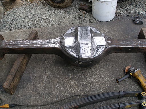

shaved the diff, still have to grind it smooth
1/2inch threw center and 3/8 plate on the rest
thanks

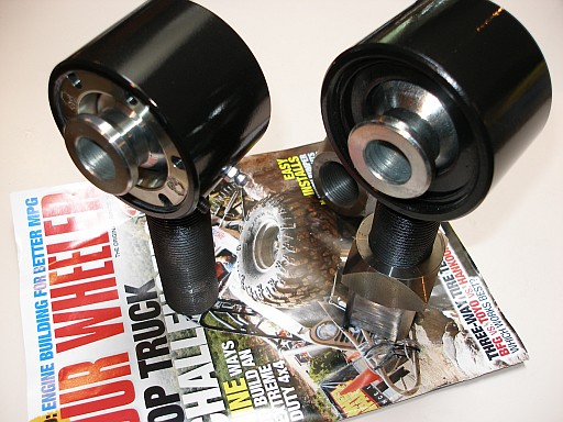

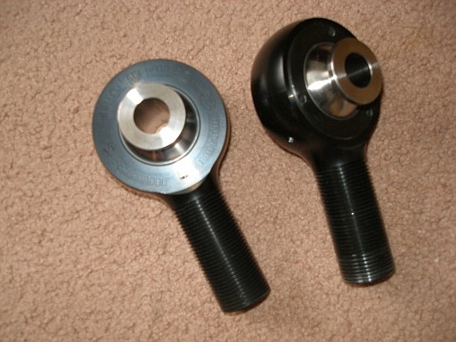

summit machine jimmy joints on the front of the links and ballistic flex joints rear side is what im thinking and triangulated center lowers with parallel outer uppers is whats working best so far with the frame and such

here's a few pics of what im using

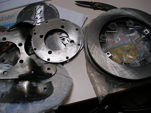

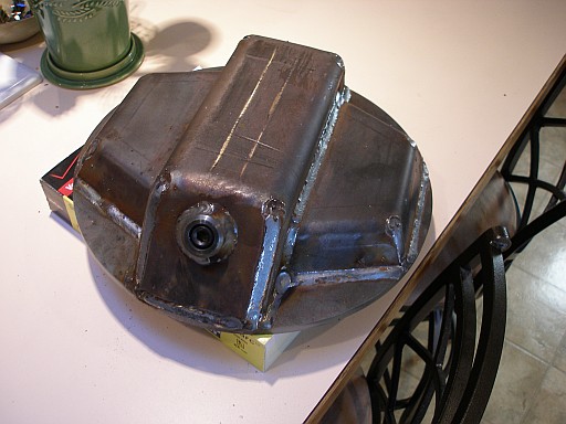

4 summit machine lg jimmy joints, 4 ballistic fab 3.0 joints, greatlakesoffroad front rockwell cover, i made the rear cover, psc full hydro steering, diy rockwell pinion brakes
