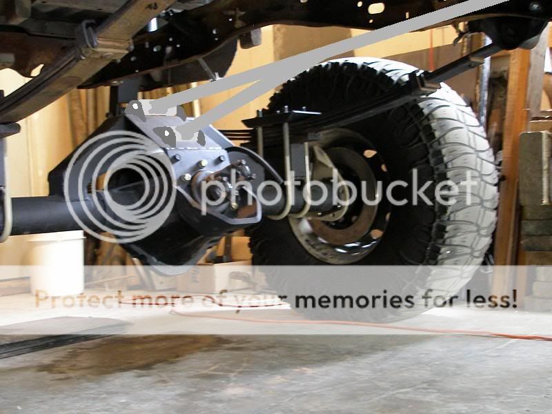

for my truck rear ranger/sploder leafs were just too soft and needed traction bars of some sort as i was kinking them. i basically used what i had laying around and tried different setups till i got what i wanted. of course i have to meet a goal, 70 plus mph freeway capacity is a number 1. then tune to trail tolerance.
when i have time and money i will run coils or coilover type something eventually i am sure.
i have done f/s trucks and jeeps, the fs use 2 in jackers generally and jeeps run waggy springs w/d60 fronts.
one thing i have always needed with leaf setups and (what i consider acceptable) road use was a track bar too btw.

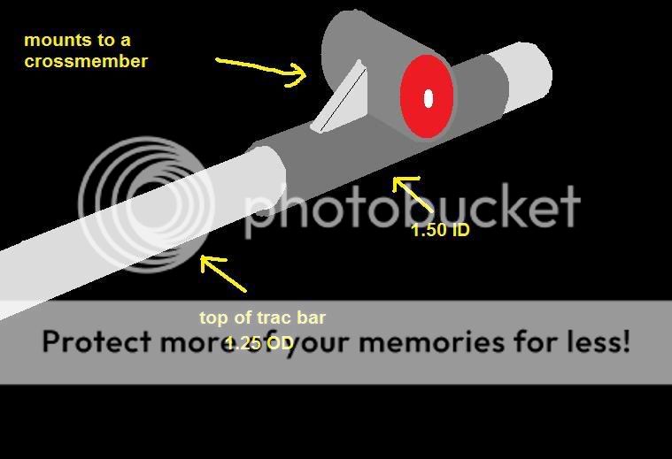

this is what i had planned on doing for the rear trac bar

i pulled it off to see if it made a difference, its simply a ranger steering link. it does most definatly restrict movement. i have modded versions of the 250 link to work in xj's before as these do wear fast. used them on other setups as well so they are adjustable. once you have it where you want it you can make your permanant link.
if you use aftermarket links its not really a problem as long as your using soft springs. implement pins are great for popping it off at the trail, but its a pia and you need tools still to drive the pin out. i am not using soft springs so articulation is not very good anyway... but the way the whole setup works my wheels stay fairly planted and get traction anyway. just incorporating frame twist:dunno:

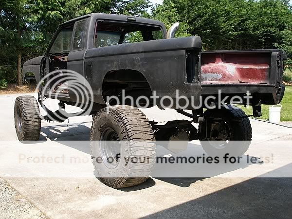

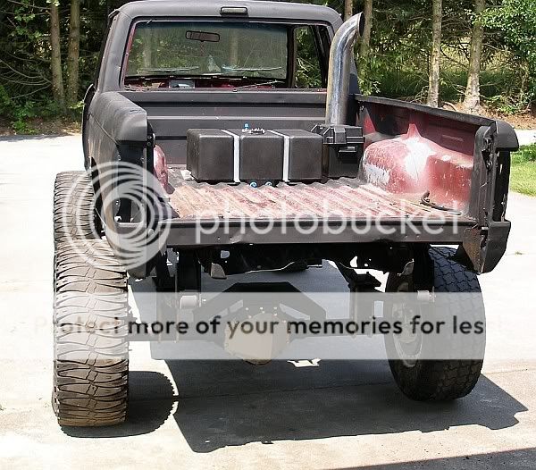

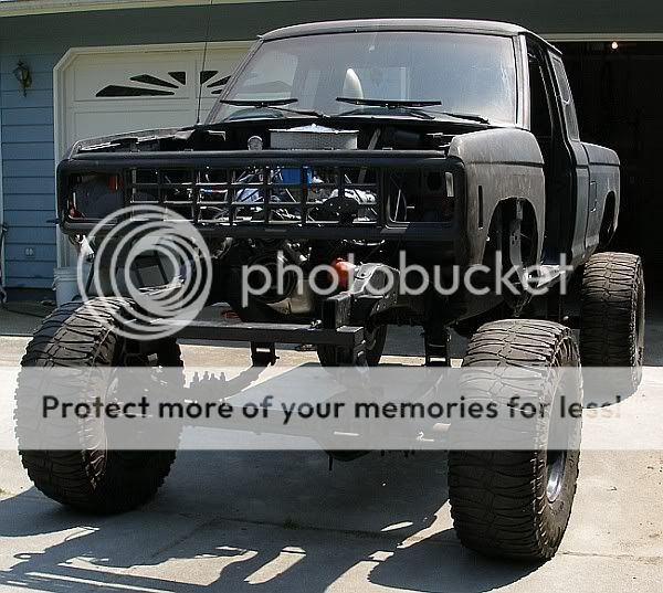

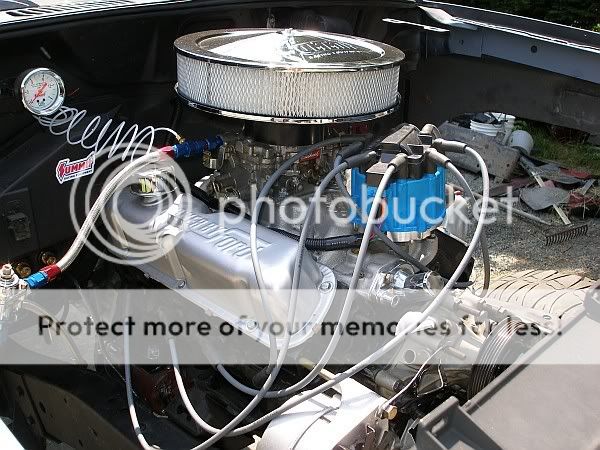

i need to get some pics i guess:dntknw:
these are phone mailed, and i am not pic savvy soo i hope they are visible.
