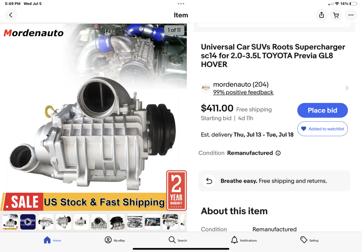

fits 2.0-3.5 sounds s interesting. Anyone tried anything like it ? Any info? says it improves power by 30% …. Doubtfull…. But even 15% would be a noticeable difference

so is the power increase good with them. And what other things need to be done … like bigger injectors, hotter spark.. exhaust .
I'd imagine all the usual boosty stuff.. colder plugs, more fuel, some sort of tuning
These are 2 lobed rotor devices with no twist in the rotor. The displacement is pretty similar to the M90. Since the M90 has 3 lobed rotors with twist, the M90 is much smoother to drive, and has much less pulsation of output. All of which makes the M90 a significantly better choice, imho.
