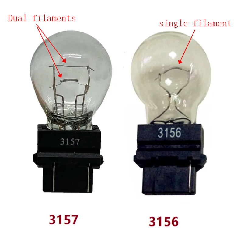

The 3157 and 3156 are two widely used bulbs for turn signals, brake lights, and taillights. Have you ever learned about these two types of lights when you were picking out LED turn signals for your vehicle? Is there still some confusion about the difference between these two? Are you not sure how to pick the right bulb? This article will introduce you to 3157 and 3156 and hopefully help you out!
What's The Difference Between 3157 And 3156?
The main difference between 3156 and 3157 bulbs lies in the number of filaments. The 3156 bulb has only one filament, while the 3157 bulb has two filaments.
Understanding the Differences Between 3157 and 3156 Bulbs
To determine whether it is LED 3157 or LED 3156, the main difference lies in the wiring. The 3156 bulb has only one wire, while the 3157 bulb has two wires.

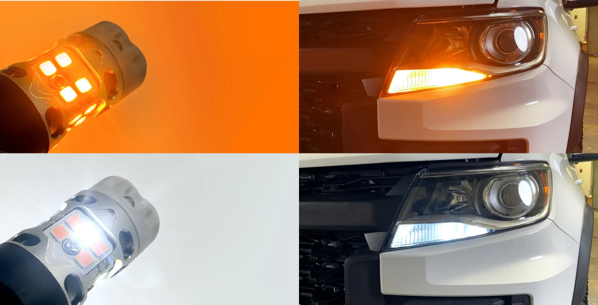

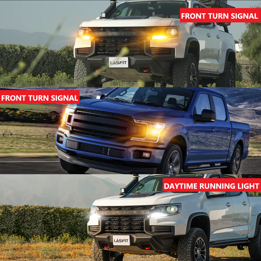

Installation Position
As for the installation position, due to the dual filaments of the LED 3157 bulb, it has both high and low brightness, making it a dual-function bulb. When used as a front turn signal, the 3157 bulb can simultaneously function as a turn signal and daytime running light (DRL). When you activate the front turn signal, the high brightness of the bulb serves as the turn signal. In contrast, low brightness is usually used for DRL or parking lights. Additionally, the 3157 bulbs can also be used as side marker lights on some trucks.
When installed in the rear lights, the 3157 bulb is typically used as a tail light and brake light.
On the other hand, the LED 3156 bulb has only one filament, making it a single-function bulb. It has only one brightness level and cannot switch between high and low brightness like the 3157 bulb. It cannot be used simultaneously as a turn signal and DRL.
Due to its attributes, the 3156 bulb is primarily used for front or rear turn signals, reverse lights, and parking lights.
