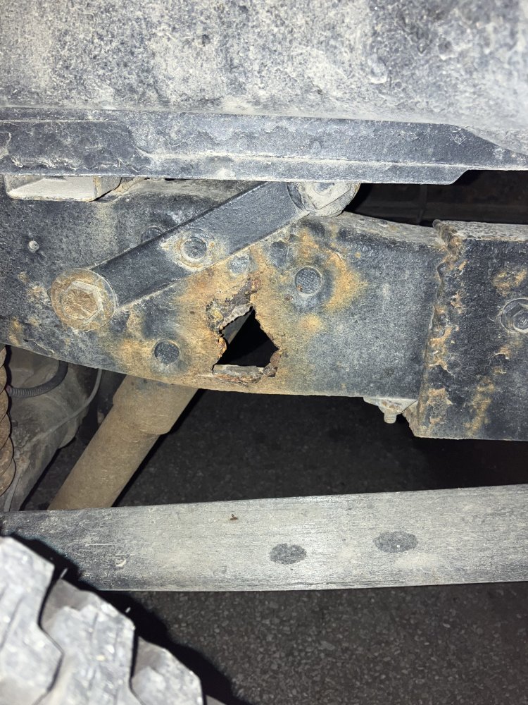

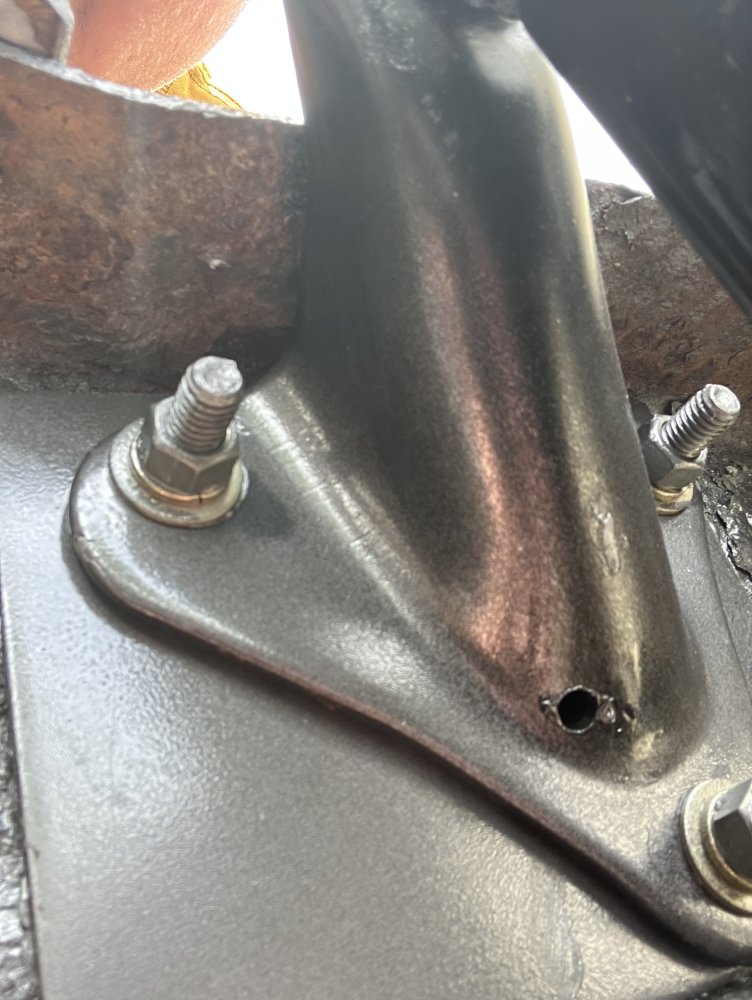

Well when I changed my tires out a few weeks ago I noticed a spot on the frame, left side where the shock mount rivits on, (The shock mount itself broke off from rust several years ago, I rigged up a new one with galvanized strap steel.) I tapped the frame where it was bubbling up and a hole appears. Going to have to pull the bed for this one, good time to check rest of the frame. I’ve already patched from the rearmost spring hangers back on both sides. It is nearly 30 years old and lived all its life in the salt belt. Still sucks though.

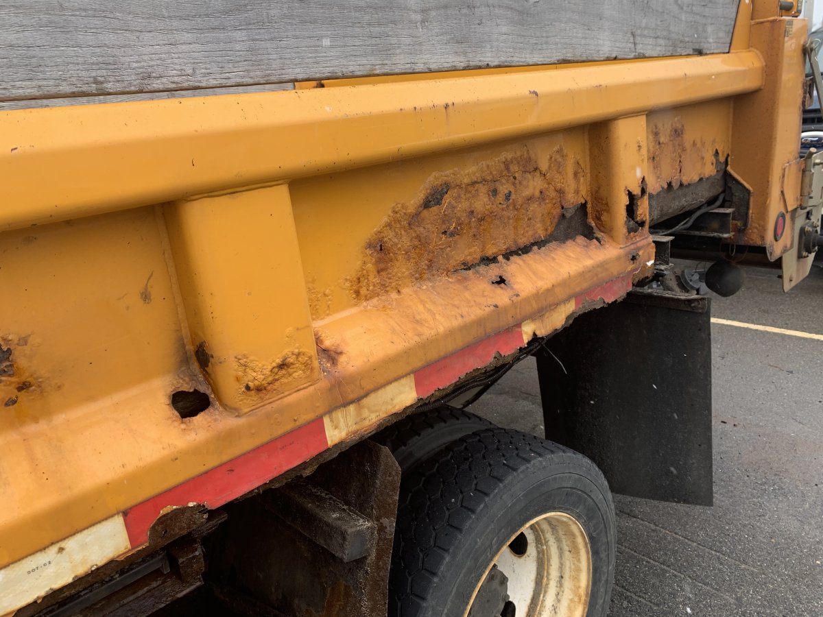

It could be worse… here’s a 2016 F550 that we’re sending to auction.

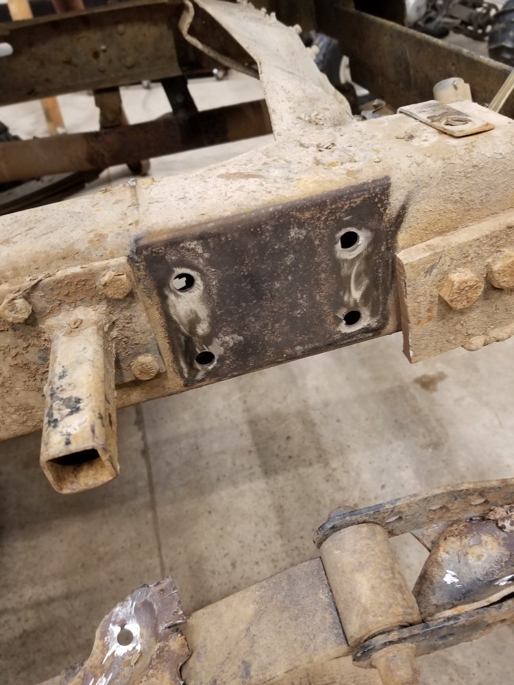

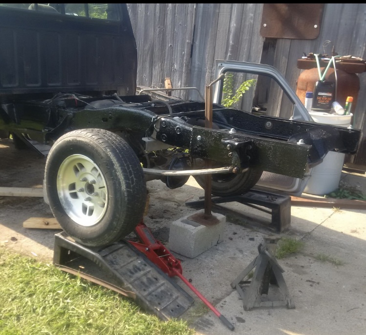

You guys live in areas where this happens on purpose? This is the frame of my '90 that I obtained in '04ish that was originally a '89, in the years since I've had it it's lived inside maybe 3 months... I only had to change the shackle bracket because it physically broke (that wrench lasted like 4 years, in my defense it was welded on with a portable spool gun in the sand dunes camp site), only minor surface rust... Everything that looks like bad rust is just grit from wheeling...

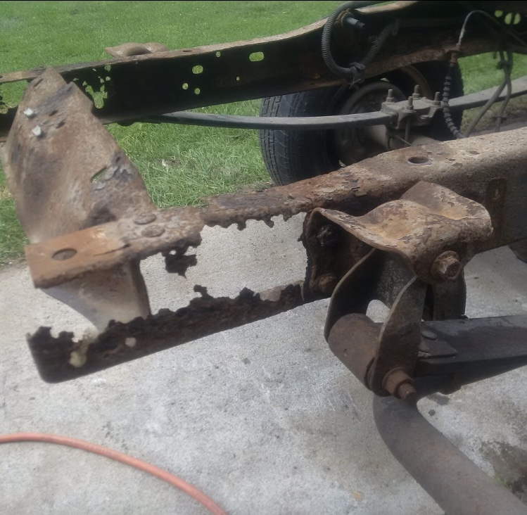

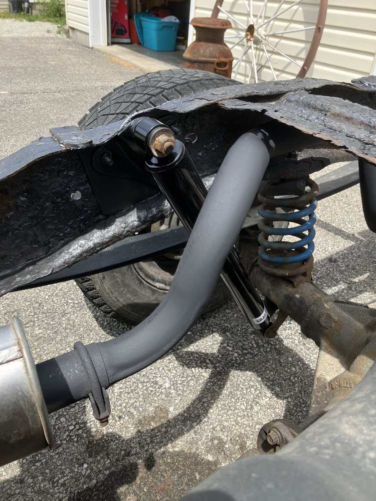

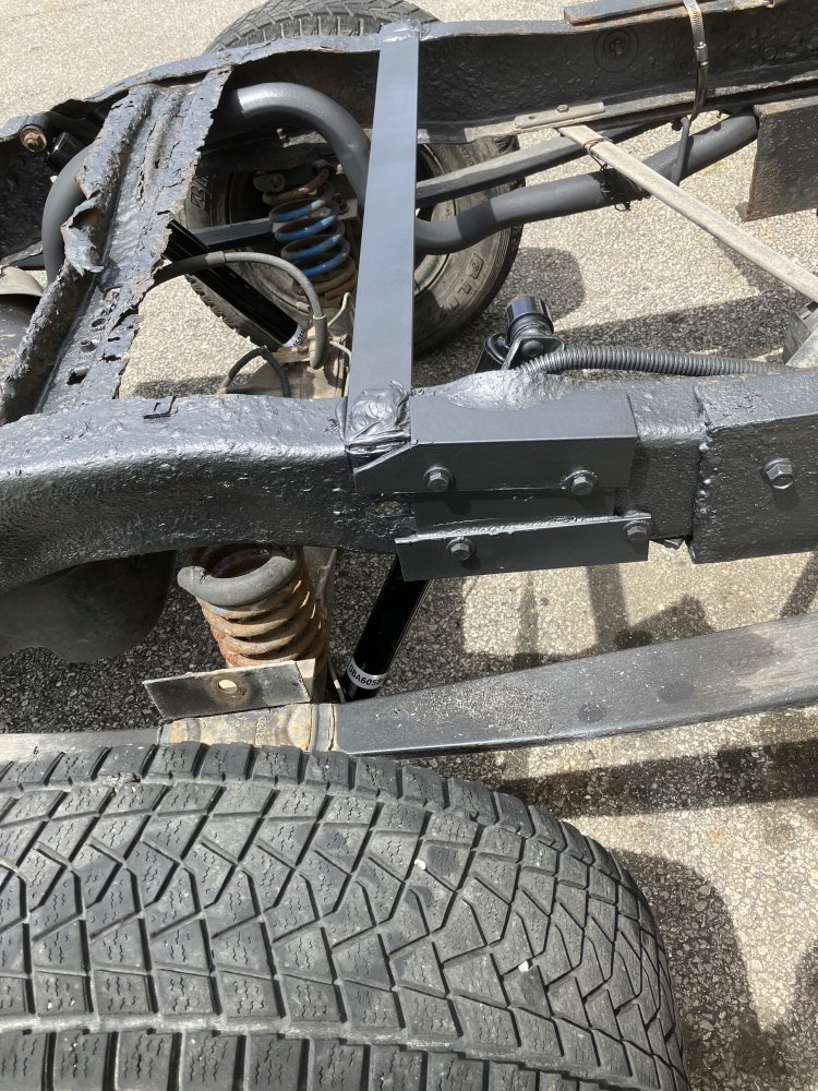

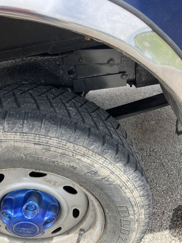

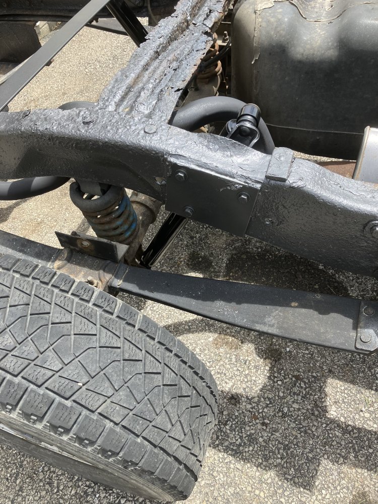

Not sure how many have seen these-pictures were when I first got the ‘94. Had no idea it was that bad until I was using the air chiesel to remove the spare tire carrier. It rained rust and afterwards the rearmost frame looked like cardboard that got hit with shotgun fire. Some salvaged channel iron from a cultimulcher (farm equipment) made it better.
Got it all patched up, 6”x5” 3/16” thick plate on inside & outside of frame with silicone between mating surfaces (to keep water out), Angle iron on drivers side top & bottom of framerail since that side was the worst. Got new shock mounts with a drainage hole at the lowest point, New shocks and some paint.
