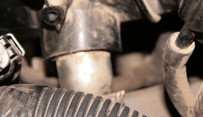

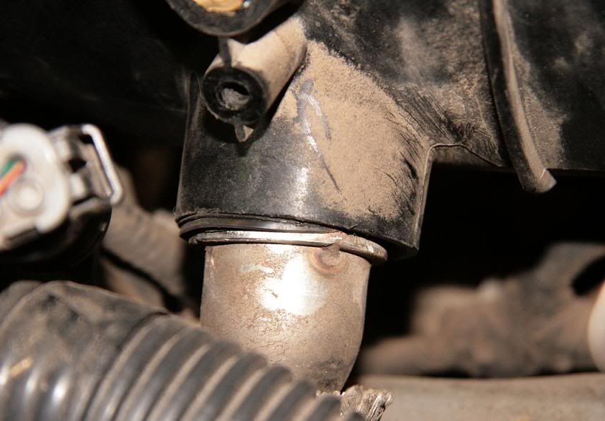

BTW, my P0174 and P0171 codes are fixed now that I resealed the intake. The main issue was indeed the EGR tube (you can see in the "bad" pic below how off it was, and the rubber seal was very deformed). Overall took me about 45 minutes not counting a break for supper in between.
I picked up replacement upper intake gaskets for insurance even though a carb cleaner test only pointed to the EGR, and since I had to take the upper off regardless. I think Napa's website has the wrong part number for the intake gaskets on a '95. At least the picture online for the '95 application showed a flat one piece gasket, which is not what my truck has. Ordering the 96 intake plenum gasket set seemed to do the trick. At $5.99 I can't complain, and there was an extra set in the box!

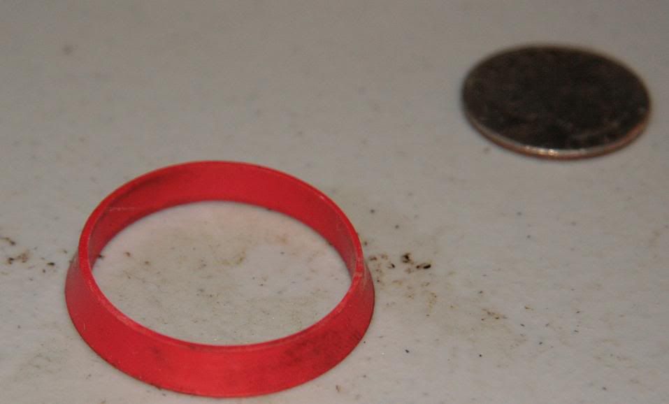

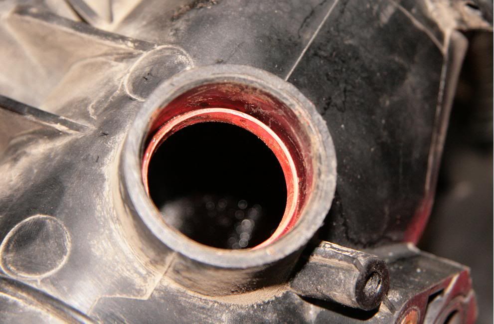

EGR tube seal was a different story. I ended up just going to Ace Hardware and grabbing a combination of a flange washer and an o-ring from the plumbing department. Pics follow (sorry the last one is a bit out of focus, but you get the idea).

Just a liiiittle bit off :icon_surprised:

1 5/16" OD I believe...

A little silicone gasket sealer to be sure.

Extra o-ring for insurance.
