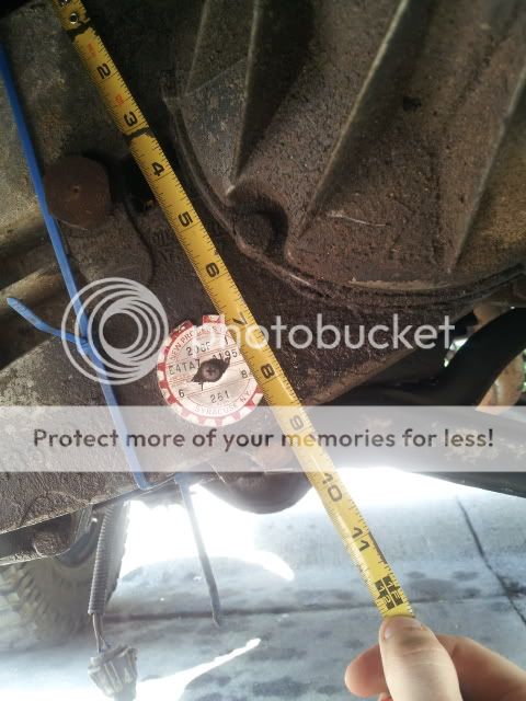

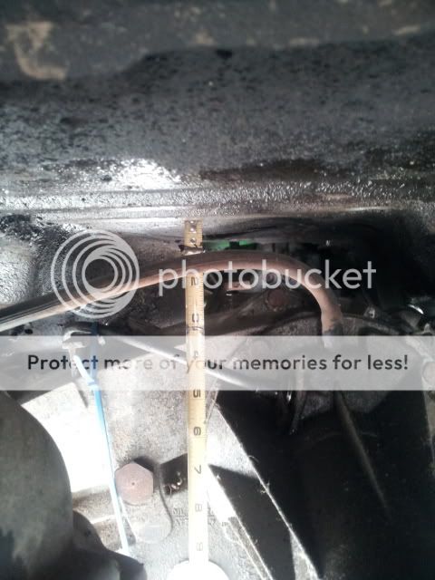

Got them, at least what I could before work.
There's two inches clearance between my floor and top of my case.
Twister 85 B2 Build
And the case is 9 inches wide in the middle.
Twister 85 B2 Build
The zip ties are holding my speedo cable in place due to the hold down bolt got broken into the case but I didn't have to lengthen my Speedo cable either. If your speedo read slow before(mine read 4 slow with stock tires) this one corrected that. But since I have larger tires it read 8 slow after I put them on and the fullsize xfercase put me back to where I was....stock reading.

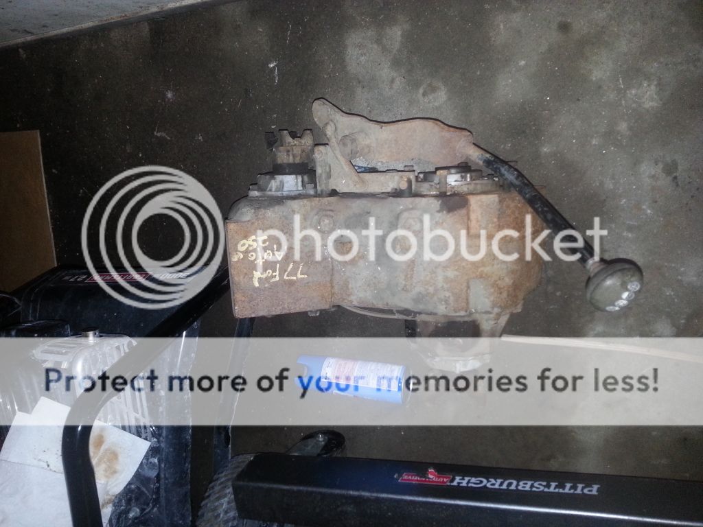

Lets play name that t-case.
Twister 85 B2 Build
Sent from my SPH-L900 using Tapatalk 2
Its an np205 :D
Do the dual stick mid to it, looks very easy to do.
And I want one of those, what did you give for it?

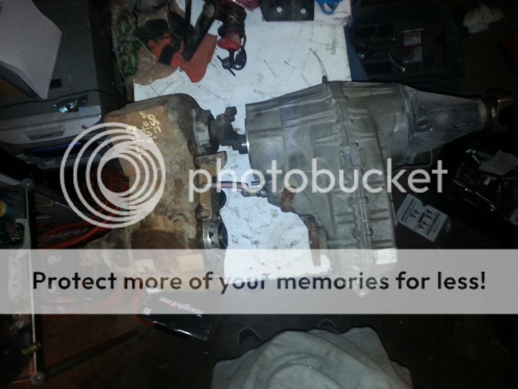

Got the bw4406 pulled out, engine and tranny pulled back out and made a template for trimming the mount surface in the rear of the transmission.
Twister 85 B2 Build
Took some measurements
Bw4406:
Width= 24.5 inch
Length = 25 inch
Top to bottom = 14 inch
Np205:
Width = 17 inch
Length = 14 inch
Top to bottom = 8 inch
So it is far smaller, just twice the price.

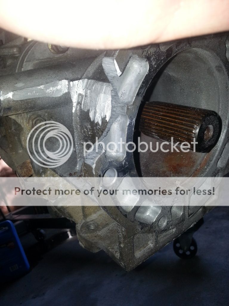

Got my transmission notched today. I tried using a cut off wheel but it got caught on the transmission and shattered :annoyed:. So i was stuck using a grinding wheel, which, with a lot of wd-40 didn't take long. The pics make it look really rough, but it looks a lot better in person. I didn't have anyone to help me move the t case to see if i took enough off as the damn thing weighs 150+lbs :shok:

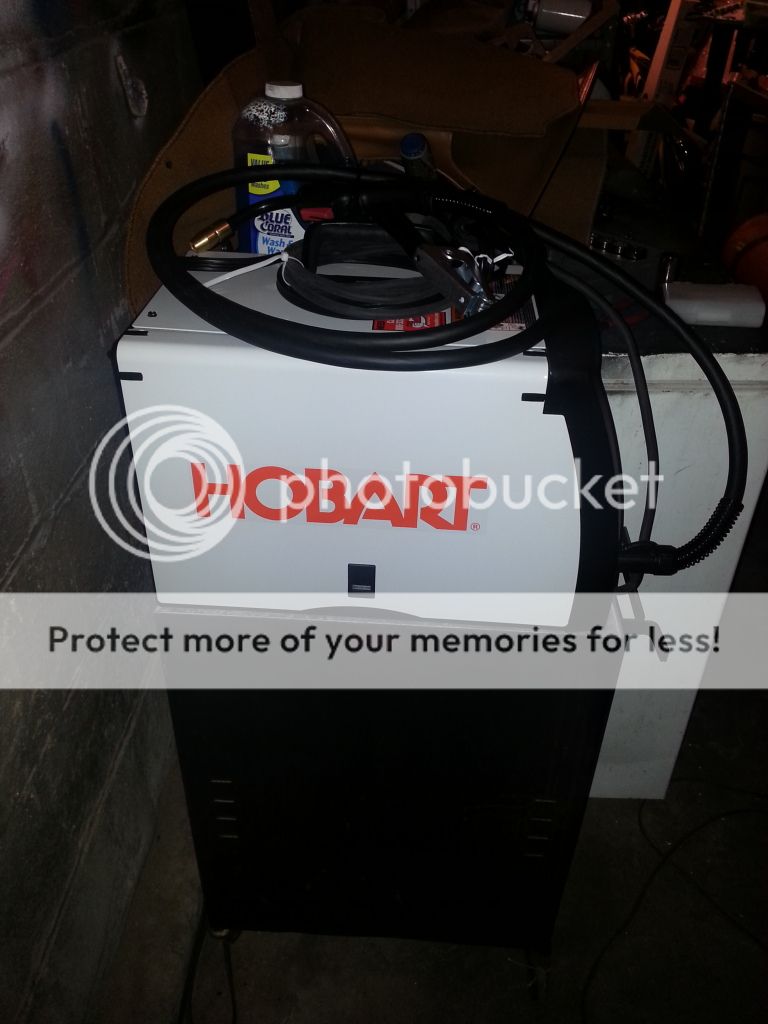

Also picked this up, got it all setup, just have to get my brother to buy the gas :yahoo::icon_welder:
