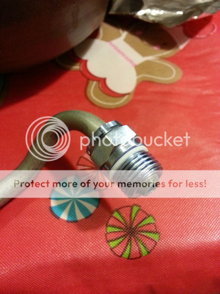

Yeah I need to buy some sealer, I was just at autozone forgot to get some :(. On to the power steering line for the explorer FEAD. I bought the line, you said I need a crush washer. Does it go on the the pump side or the steering box side? It came with what looks like the washer on the pump side.
Mine did not come with that washer, you should be good to go.

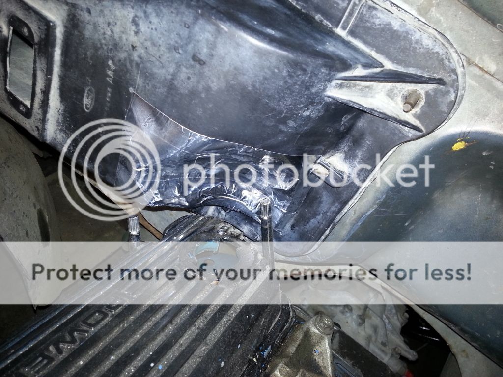

I am taking the engine to the machine shop tomorrow or Saturday. I did get the heater housing modded to fit around the engine. I accidently burned a few small holes in it so I found some metal tape wrbhad laying around and cover it up. I think it turned out better than I thought it would.
Sent from inside my spare tire.
I burnt a big hole in mine, used an oil filter to help shape it.
To patch it, I used foam weather strip tape, cheap quick solution that has been working food at patching holes, around the shift boots, etc... at least keep as much of the heat out of the cab as I can.

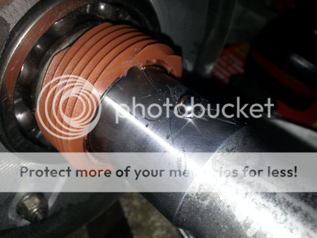

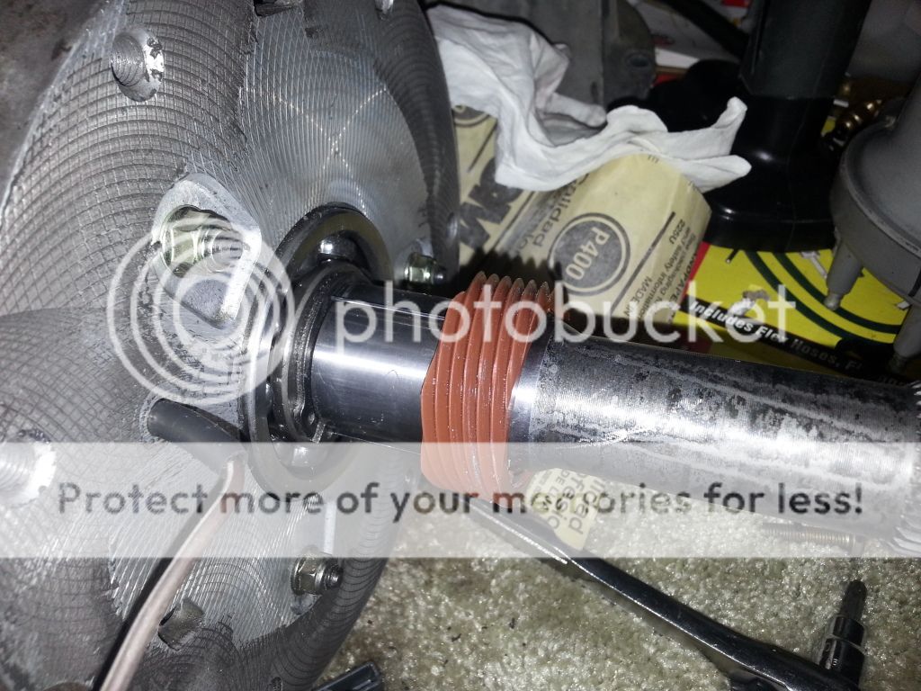

Got my engine back from the machine shop today, guy i took it to did an awesome job, it seem like he was able to get the old bolt out, and it seems he chased all the other holes for me. I got the timing set replaced, i need to get bolts for the water pump, i bought some at ace but they don't sell them in 1/4" increments so they are all too long.
