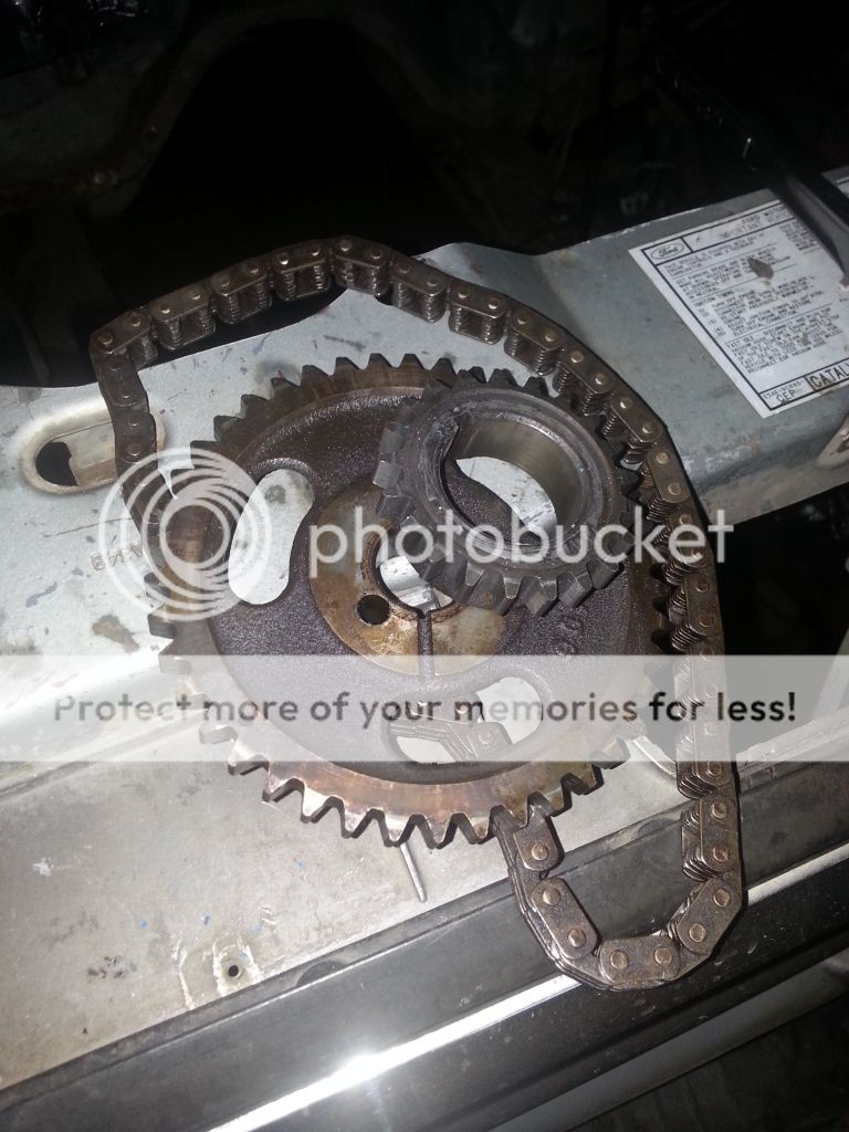

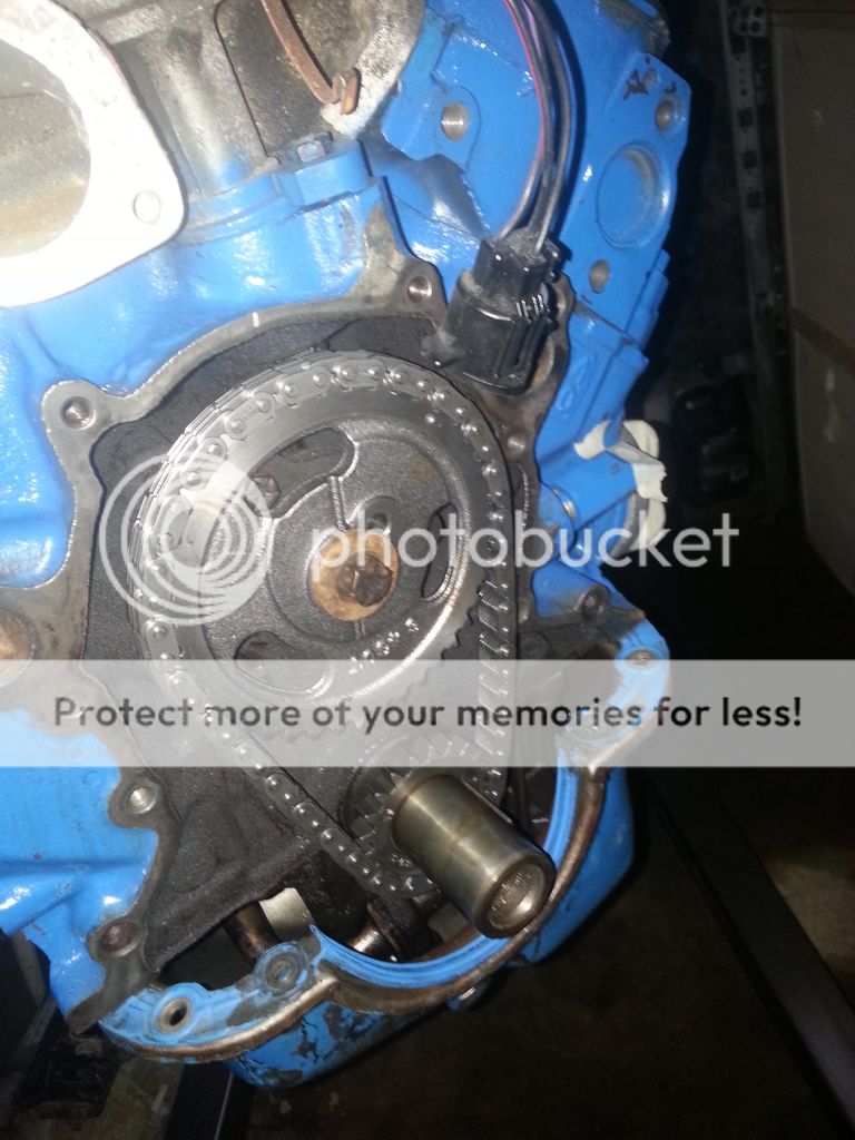

Pics of timing set
Old
New

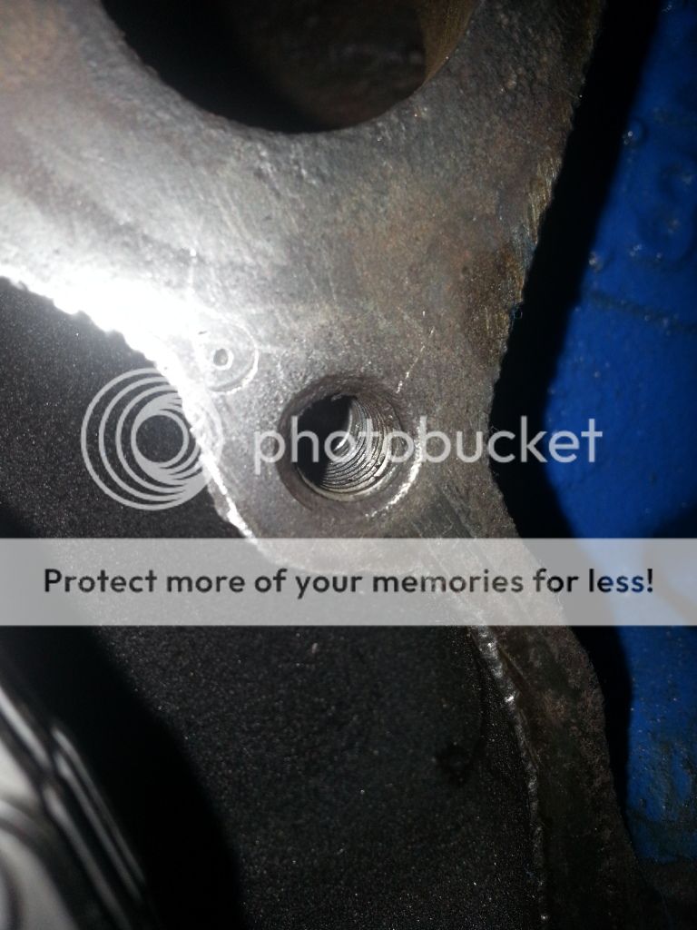

Old bolt
Fixed Bolt hole

Now things should move right along and smooth.

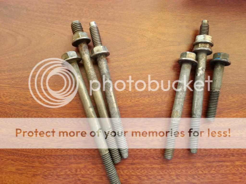

Searching various years and models with 302s it seems once they went to the one piece they all took the same one. So I got that replaced. Went to the junk yard today to get water pump bolts as the hardware store doesn't sell bolts in small enough length incraments. Got all the ones I needed, was a little scared at the condition they were in tell I soaked them in clr for an hour, they cleaned up nicely. I am going to try and get the timing cover and water pump on tonight, I need to pick up a clutch slave cylinder before I can throw the engine back in.
Bolts after clr, before one looked like I could break it in half because it was so rusty.

Now that I look at your fixed bolt hole closer it almost looks like the guy did a helicoil to it, nothing wrong with doing that either just as good of a fix.
Alot of people that do restorations go to the JY for OE bolts.

If he did then he did one hell of a helicoil job lol.
