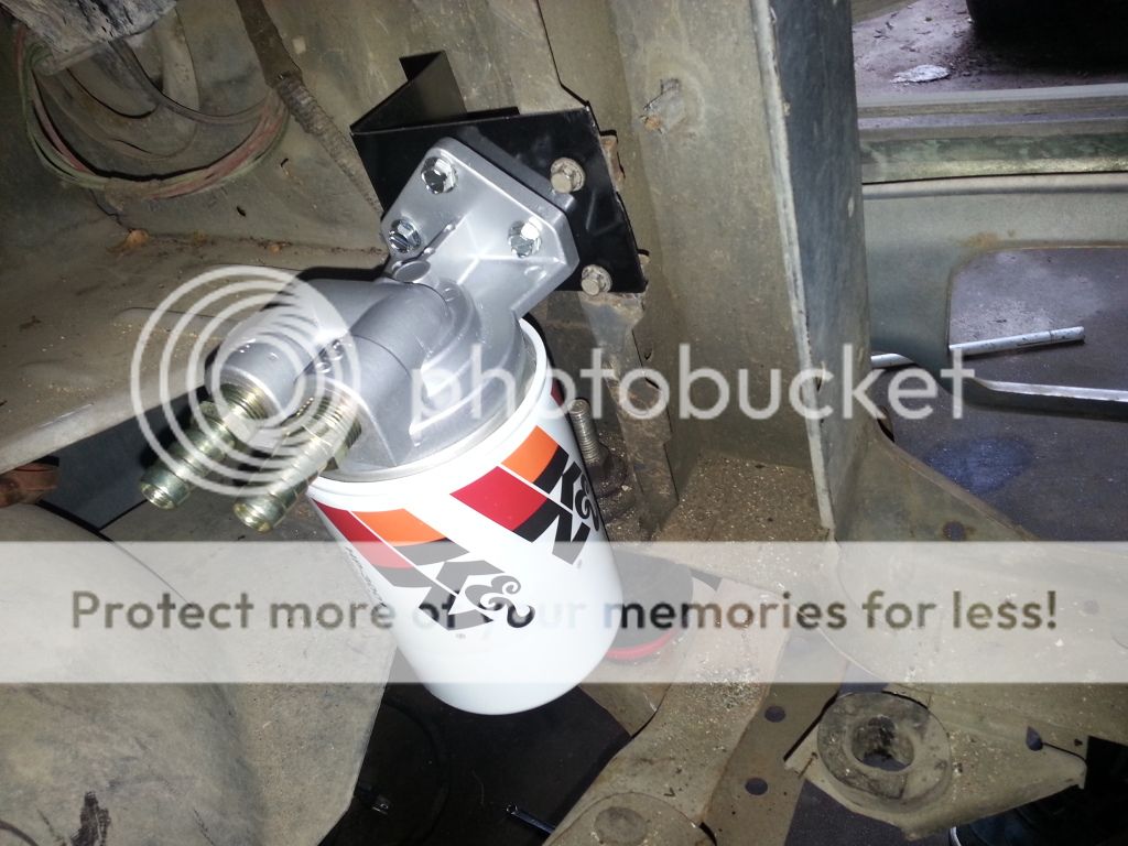

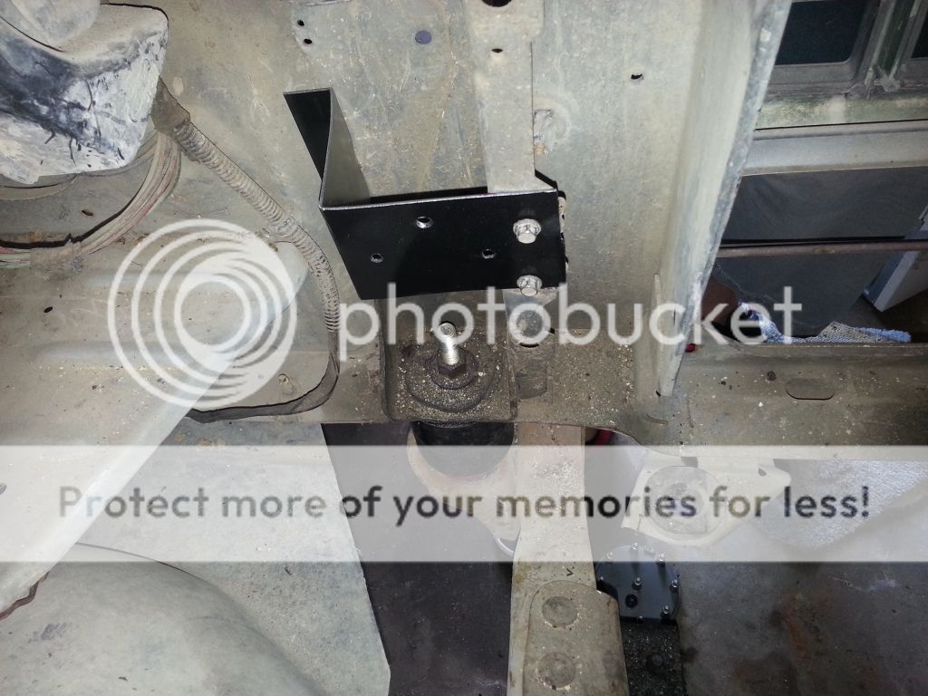

Got my oil filter relocation mounted hopefully in its permamnent spot. I made a little bracket that bolts onto a factory location on the radiator support.

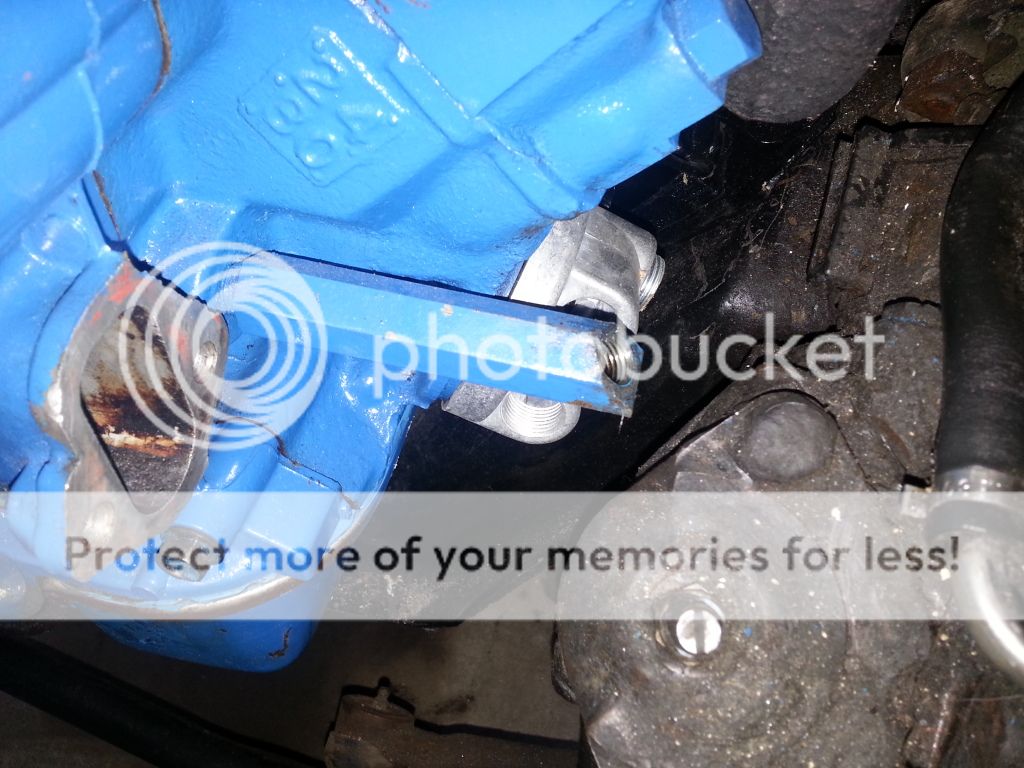

Cut the tab off my t case, just need to grind it down a little.

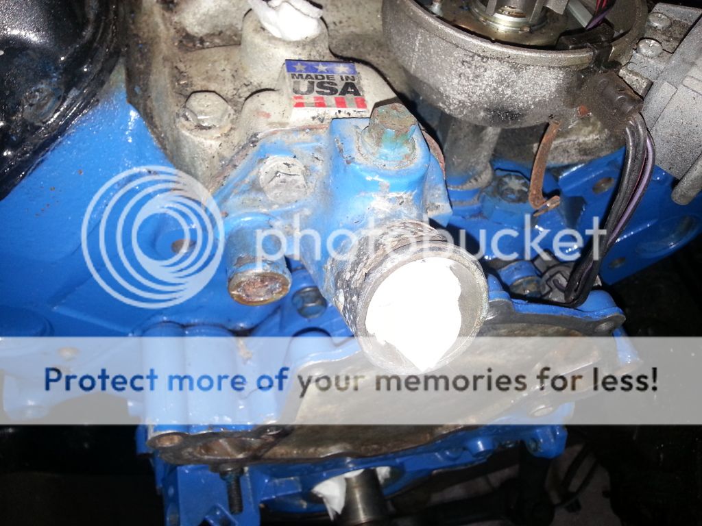

Also questions on explorer setup. Do I need to change to the explorer t-stat water neck or can I use the one that's already on my engine (pic below). I grabbed the explorer one while I was at the junkyard so if I need to it would be simple.

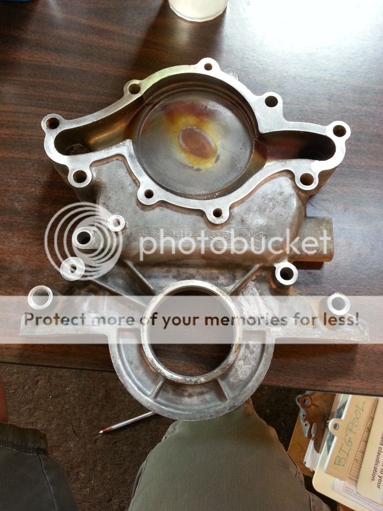

What is this hollow metal bar that sticks out behind the timing cover and is it needed?

Also got by timing cover today :)

That hollow metal bar is where you hook a oil pressure sensor or fitting for a manual gauge. If you don't ho anything into it and leave it open, be prepared to have oil come out of it when the engine runs.
That too is where I have my oil filter mounted, only I used existing holes that my truck had to mount it. It's nice not having to be under the truck to fight it off.
I do want to run an oil cooler at some point but since my rad sits so far forward, I doubt know where I can run one yet.

You will need the 90* housing to clear everything else. Also make sure to get one that has a port for a temp sensor.
At O'Reilly's when I asked for an Explorer one they didn't have a hole, one for a 1995 Mustang had a hole.
+1 on the oil pressure tube. If you are only running an idiot light you don't need one otherwise you will need it for the sensor. Mine had an idiot light so I used the tube off of my 2.8 which worked fine but wasn't as long.
When you put it all together don't forget the timing pointer. :icon_thumby:

Yeah I need to grab a timing pointer from something. Do the explorers have one on them? Also I have a temp sensor plugged into the intake manifold so I think ill be OK with the t stat neck having no hole.

No, the Explorers have a crankshaft position sensor in the pointers place. That is why your balancer has all the funky bumps going around it.
I have my gauge sender plugged into my intake and the fan controller in the t-stat housing.
