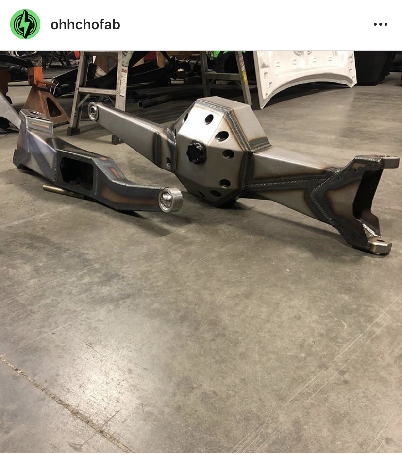

theres a guy who makes what youre talking about. if you have an instagram, i would try to get in contact with him and see if hell sell you the ends of his production TTB's
  • Twin I Beam Fabrication Question
Okay, so you think 4130 would be okay for the ball joint tapers to be machined into? And ya that'd be great to get more information. Thanks!
found it and edited my post above^^^^
but yes. 4130 would be the best material to use.
