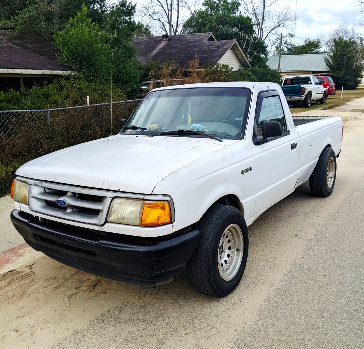

Planning out my turbo build for my 97 2.3. Found a donor 83 TBird and a decent T4 Garret turbo kit. Only thing left is the ECU. I've been researching options and have just come up short on what to do. I've seen people recommend the Tweecer RT but I've also read that it has several issues with usability and user friendliness. Megasquirt seems like the most viable option but have been lost on which one to even get. Just need some suggestions on a good standalone that's reasonably easy to use (and also preferably on the cheaper end).
