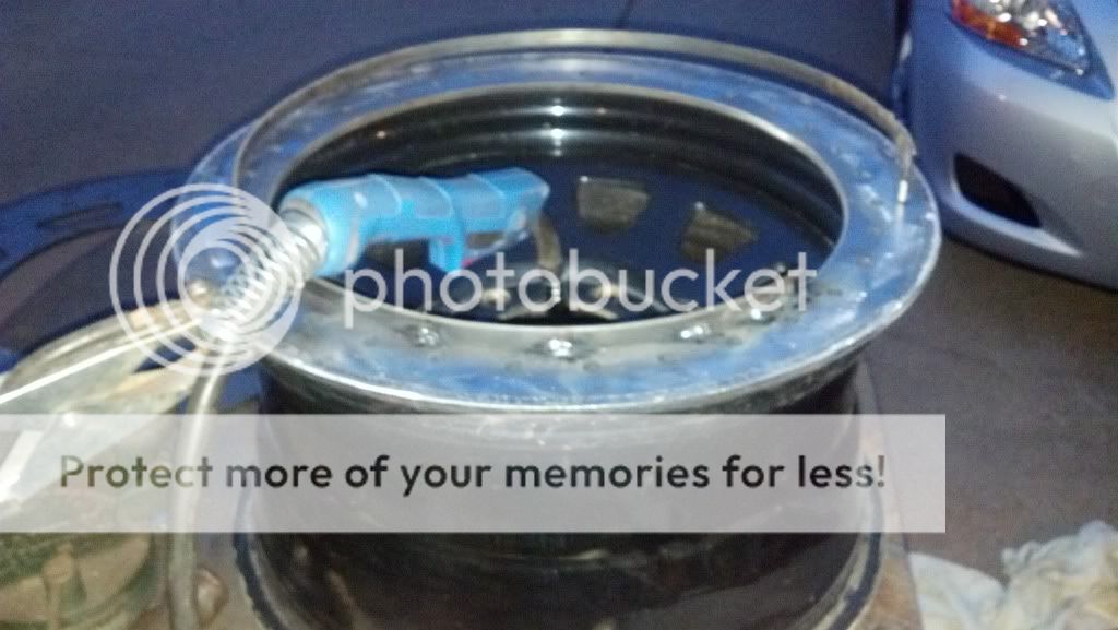

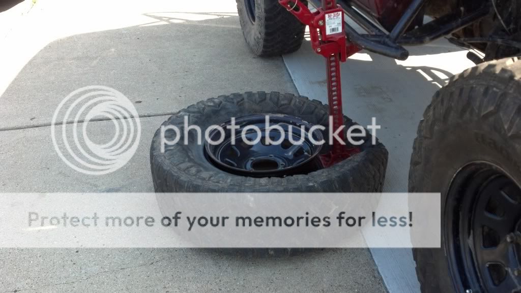

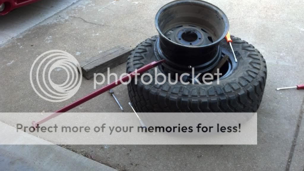

Started on one of the wheels. Dismounted the tire with some screwdrivers and a Hi-lift.

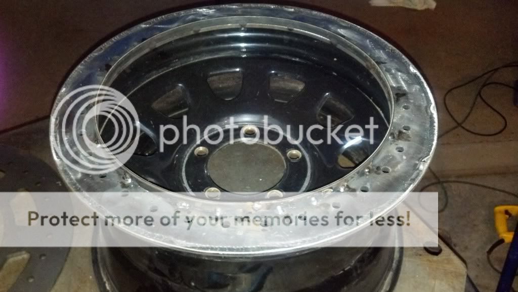

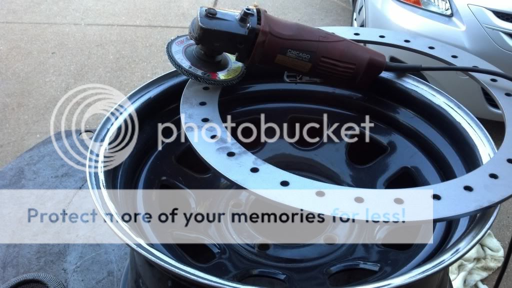

Cleaned the lip with a angle grinder.

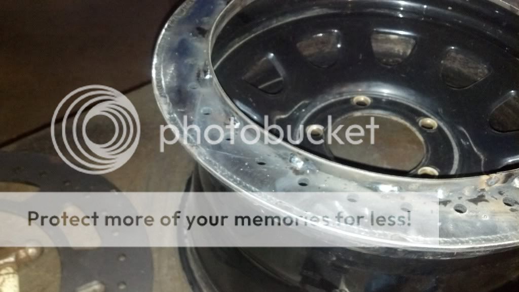

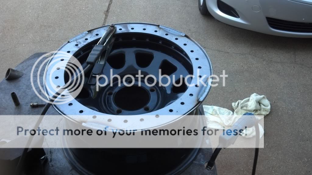

Centered with 50 cents on each side and tacked.

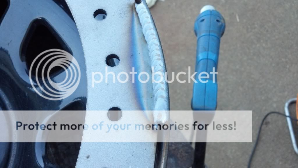

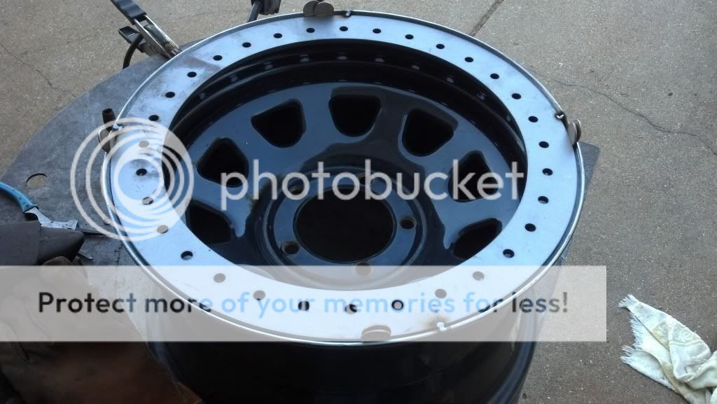

Started welding 2 bolt hole sections at a time.
looks really good Greg:icon_thumby::icon_thumby:
gonna be a nice addition to your rig....
