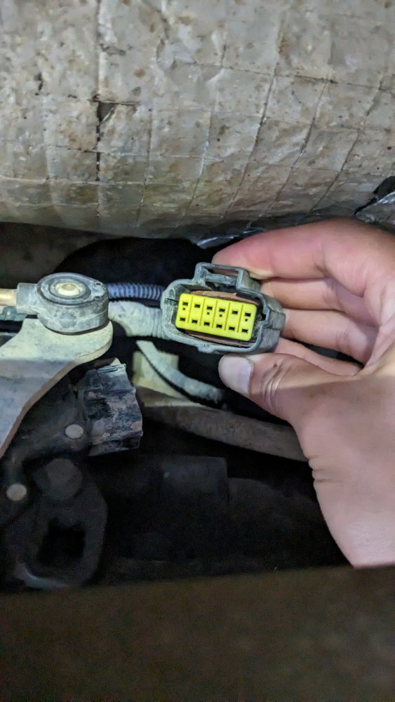

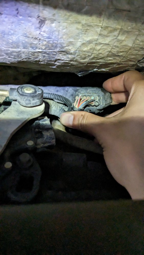

That don't look like mine that I can tell, it's also 13 years newer than mine (which still works perfectly)
