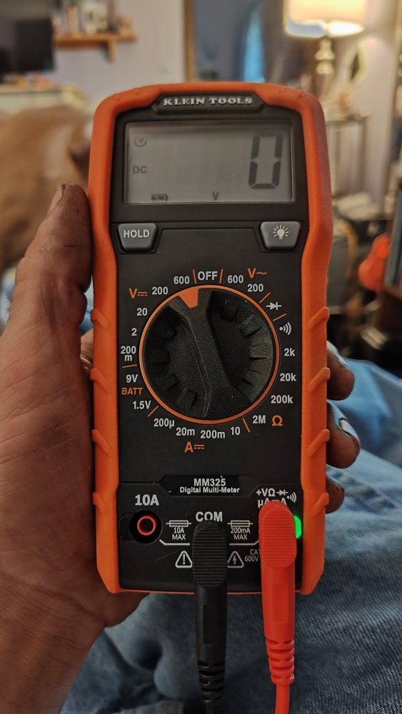

It as if the voltage was slowly climbing, I don't think pulling the fuses had anything to do with it.the voltage creeped steadily until the audio system fuse was pulled.
That's weird that pulling a fuse would put a draw on the system.
It didn't. With a draw on the system, the voltage was lower because the battery was under a load. So pulling the fuse that has the draw removed the load and battery voltage went up. He got decent results by doing the test wrong.
The parasitic drain test should be done by measuring current. Not voltage. Go back to the procedure I posted yesterday.
As you pull each fuse it takes a little bit of the load off the battery, if there is a load. So the voltage creeps up. But it doesn't make sense that the voltage dropped when he pulled the radio fuse, it should have creeped up when the keep alive was disconnected.
I agree. But the radio load should be so low as to be negligible. We might just be seeing normal error in the readings there. Testing by this method (watching voltage instead of current) is not nearly as accurate or reliable in this case as using current readings should be.
Ok. Apologies guys. Work was nuts there for a bit. Anyway. I tested currant. The hot wire to my radio pulls 15.7 ma with the ignition on, and it slowly climbs to 16.7 is the highest.
