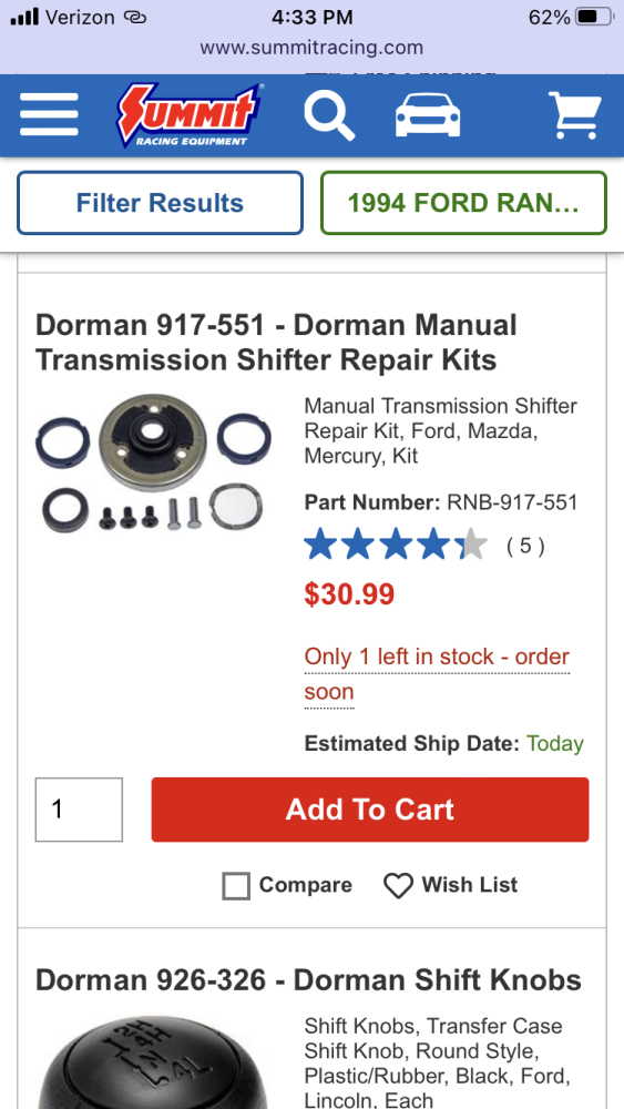

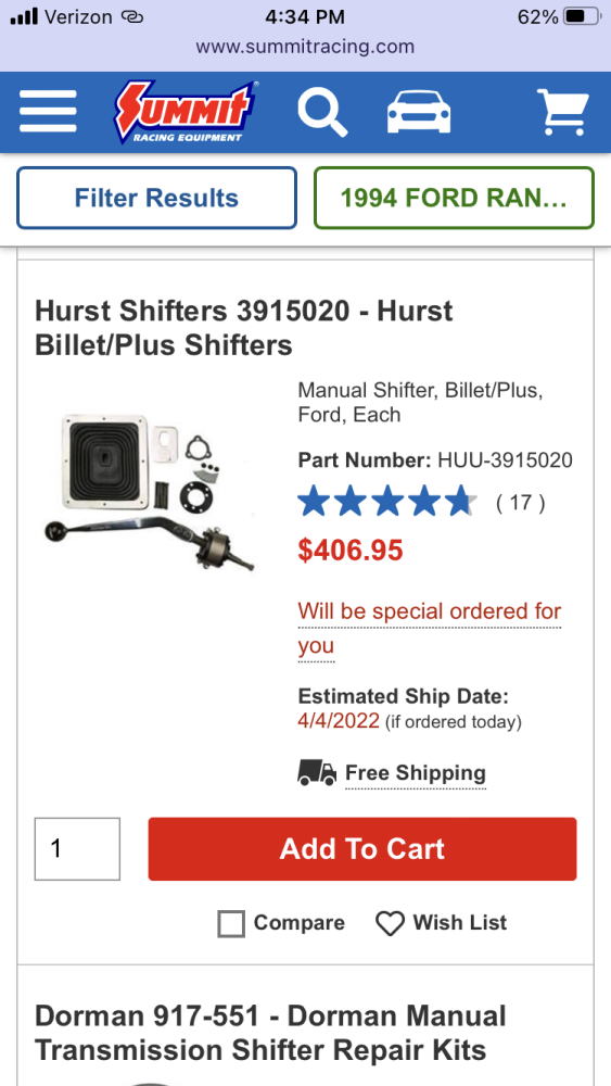

looks like part of a wave washer from the shifter bushing assembly. Probably has a sloppy shifter. easy fix, $30 bushing kit from somewhere like summit or just put a hurst shifter in it. (much more-over $200 last I knew , but Im still loving mine)
edit- wow, the hurst has really gone up, Id still consider one though. mine is in its 2nd ranger and has over 50K miles on it between the 2 trucks it was in.
edit- wow, the hurst has really gone up, Id still consider one though. mine is in its 2nd ranger and has over 50K miles on it between the 2 trucks it was in.View attachment 73374View attachment 73375

That hurst one was actually what I’ve been wanting to go with, but just haven’t made up my mind on dropping that kinda cash
