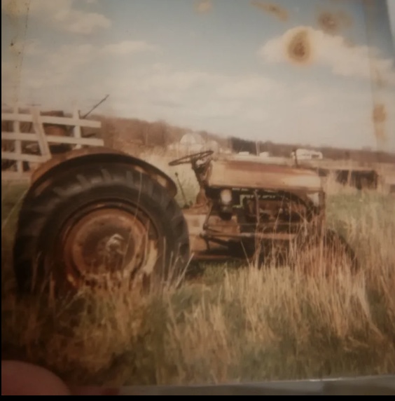

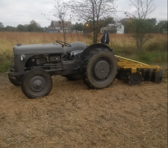

In case you dont know what Im referring to, heres dads ‘46 2N, bought new by his parents the year he was born. First picture was about 1977, 2nd picture was just a couple of years ago after I gave it a refresh and paint.
