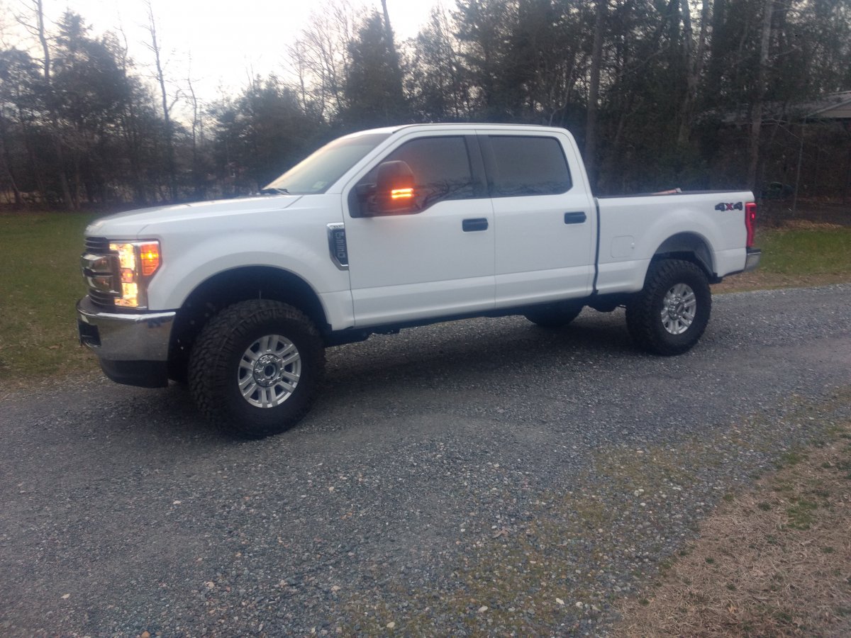

I get about 12-13 mpg hauling vehicles, you should probably expect to get around 10 or so.

Yes, ecoboost engines can be real gas hogs when towing a bigger trailer load since the engine is going to be in boost most of the time. Not a huge deal if you don't tow all the time but if you do it on a regular basis, the Ranger might not be the best choice since there is only one engine option.
That's what the super duty is for but the ease of the daily driver having a trailer hitch is often too convenient.
