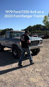

Speaking on this subject: I just saw ( on tik tok ) SC F250 body swapped onto a 2023 Ranger Tremor Frame. Just goes to show how much trucks have grown
This is the best pic i can find. The videos go into detail of how it was done.
I seen that somewhere.
Blasphemy in my opinion
