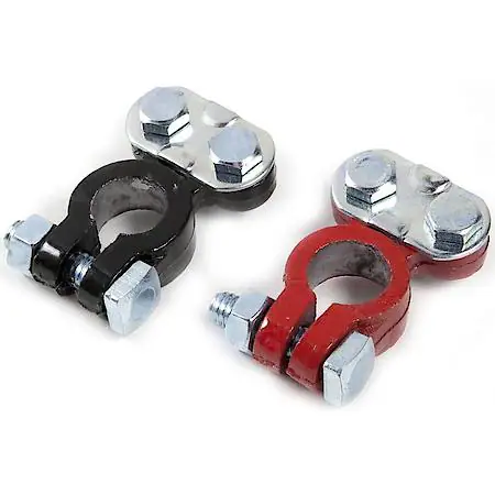

Thank you for all your replies, I figured it out 30 minutes after posting. It is indeed a loose connection, and I suspect it is the battery clamp. The connection between the battery terminal and clamp were fine but the wires inside that clamp were a little loose.
I knew I had power to the “little” wire, because I heard the solenoid click, but the real issue was I had 2 volts at the main positive connection on the solenoid. Well, I knew from all my diagnosing that the issue lay between the solenoid and the battery. So, I stuck the keys in the ignition, and left the door open so I knew when power would be restored from the key chime. The first thing I did was grab the main positive cable coming off the battery and immediately I heard the chime loud and clear. The only thing I noticed that moved were the wires clamped in the battery terminal, so I think that was the issue. The real issue is that I couldn’t recreate the problem. I barely moved the wires at all and it fixed it, but vigorously shaking the wires had no effect at all. I had replaced the terminal clamps for the battery a month or two ago because the old ones were nasty. I used the generic one from O’reilly’s which were well painted and meant that the connection between the wire and the clamp wasn’t great. I figure I’ll file off the paint and see if that holds better. Thank ya’ll again.

Glad you got it fixed. If you are using these, they will eventually fail again and again and again and again and ag...
It is well worth the money to buy new cables or get better terminal clamps.

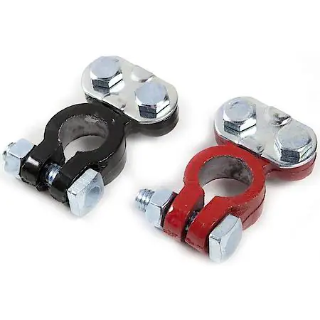

How did you know? I was using those, when I saw them I thought they would be great, do you have a better suggestion?
