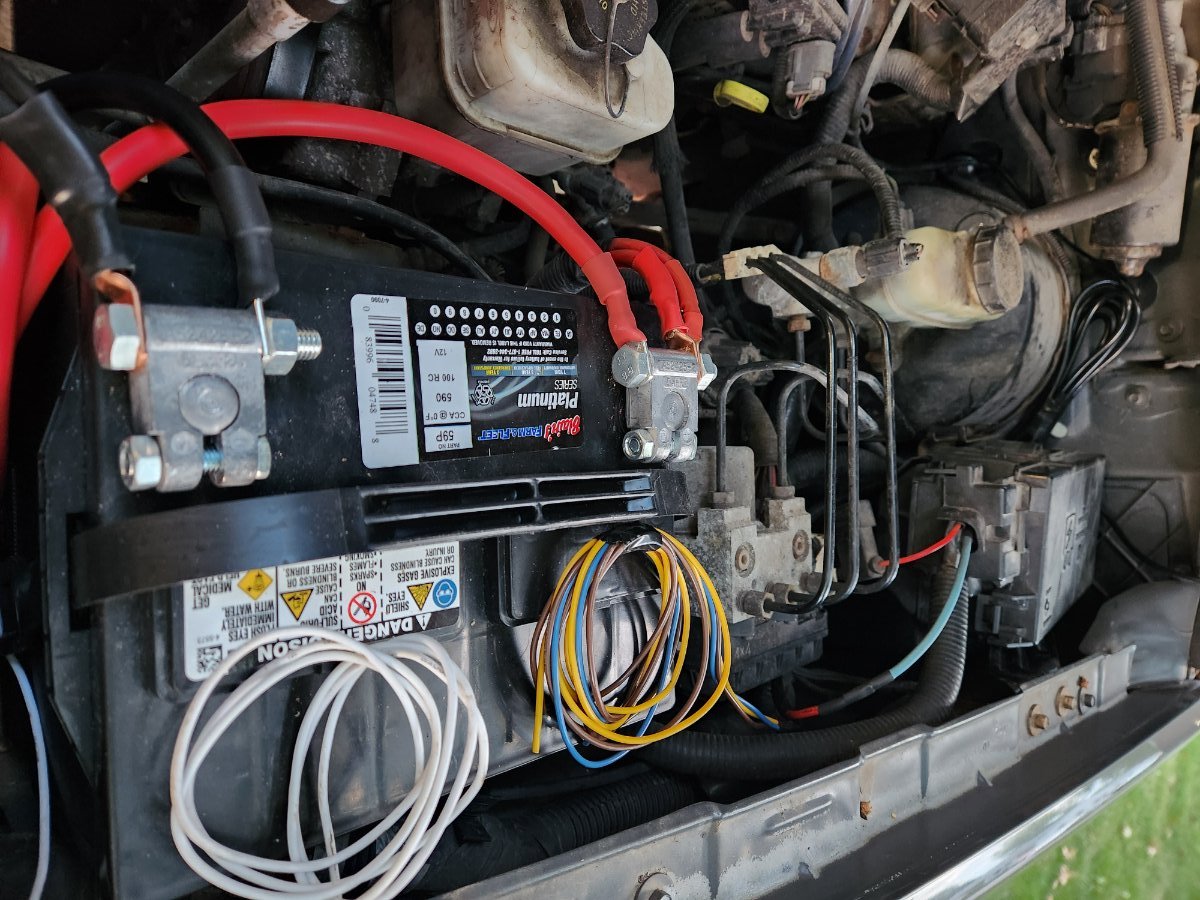

I used that style clamp for like... ever. I just changed them when they started to look rough.
This year I switched to Mil Spec clamps. I'll never go back. The down side is you have to crimp lugs on your cables. I ended up buying the crimp tool and copper lugs to complete the install.

^This is the way to go, but definitely a serious mod. Took me all afternoon to get the right eyes in town. (I was adding a winch at the same time.)
