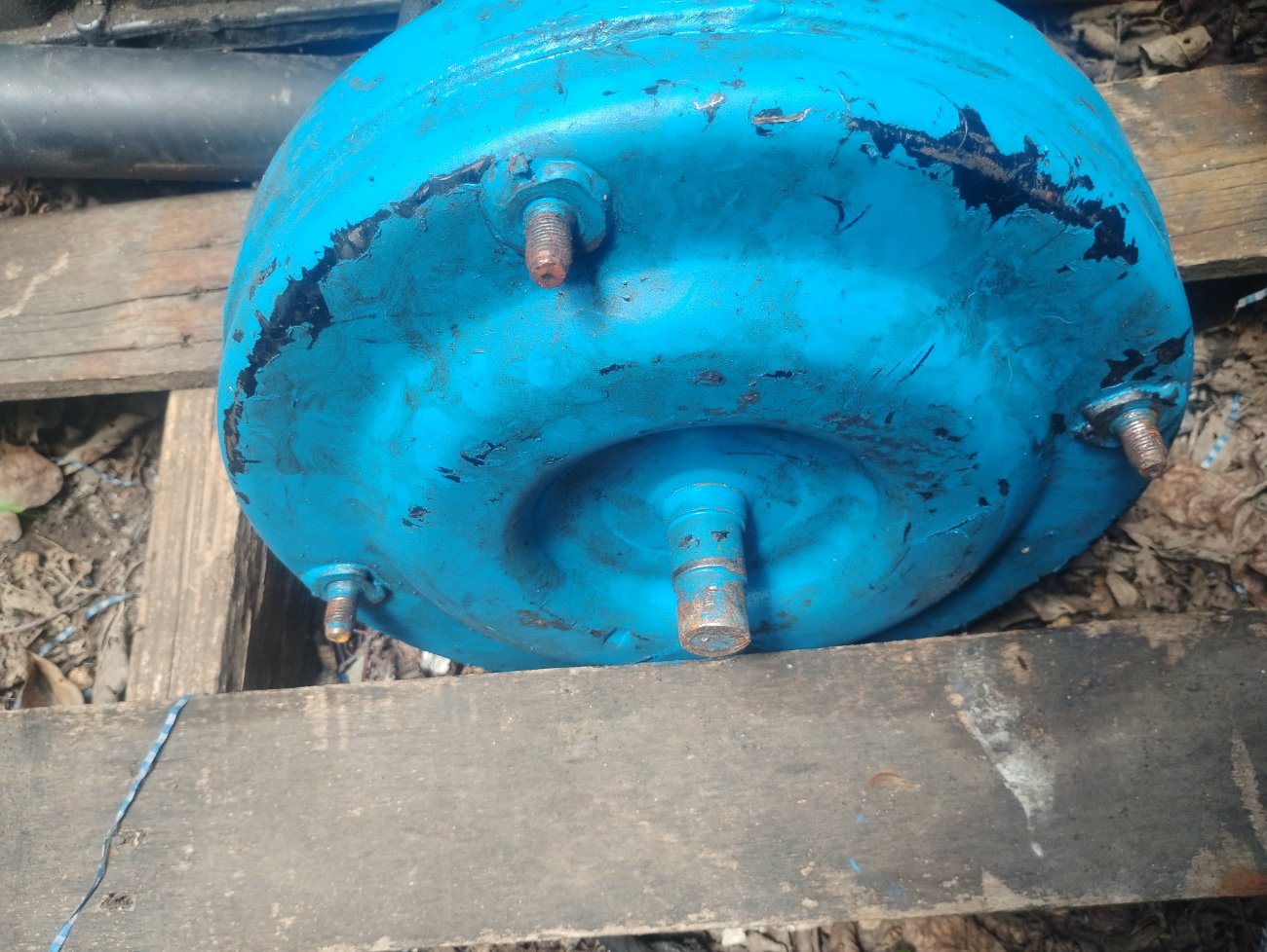

Yeah I figured it out at 3.0 and the 4.0 don't really swap out. I mean you could but you would have to make the input shaft a couple of inches shorter or after everything is tightened down the torque converter and no longer spin inside the transmission. True story about 5 or 10 hours of Labor just figuring that out. Back and forth, transmission up, transmision on ground. Stop sign say, no pay long time.
Interesting. I’m not sure I really see any reason for the difference unless they are different stall speeds. Or some engineer trying to justify his/her existence…
