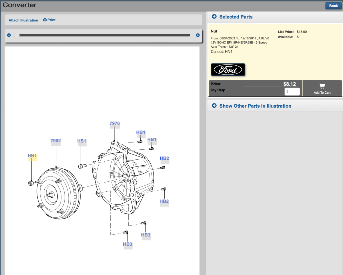

For anyone that stumble across this thread, here is the answer. Applies to 4.0 SOHC with 5R44E and 5R55E Auto Trans manufactured from 08/04/2003 to 12/16/2011. Ford part number is 378941S441, you need 4. Yes, everything else is metric, and yes... these are not. 3/8"-24, you can search "torque converter nut 6717" for an acceptable alternative.
EDIT - added year range in case screenshot can't be viewed
