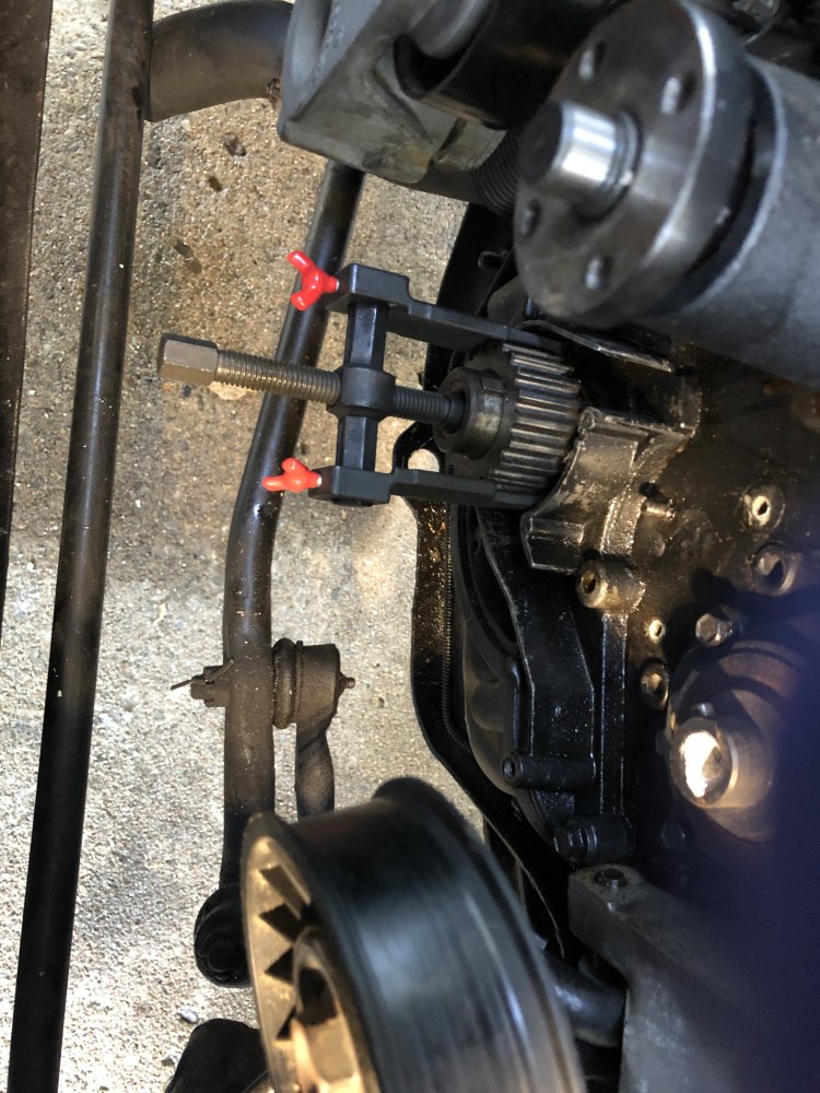

I have a very stuck timing belt crankshaft sprocket on this '94 2.3L. I've tried the steering wheel puller trick with 2 different ones, and they just keep bending. I even used hose clamps to bind the things to keep them from spreading, but they are still bending at the end and it's going to end up cracking the aluminum housing, so I can't push my luck any further with that method.
Does anyone have any other ideas on how to get this thing off? The rotunda tool is around 400 bucks in ebay money, and I can't find any aftermarket equivalent.
Are there any other voodoo spells you guys have used to get this thing off? the crank main seal is leaking and I've got this all torn apart and now I'm stuck.
If anyone is in the Indianapolis area and has the tool, I'm willing to leave a healthy deposit (enough to buy a replacement) and even some rent if I can borrow it for the day.
I don't know what else to do.

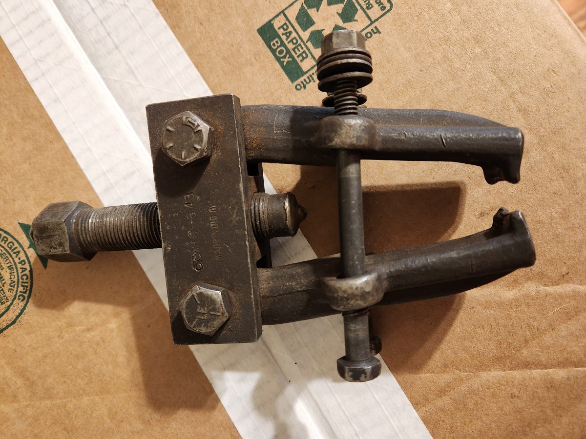

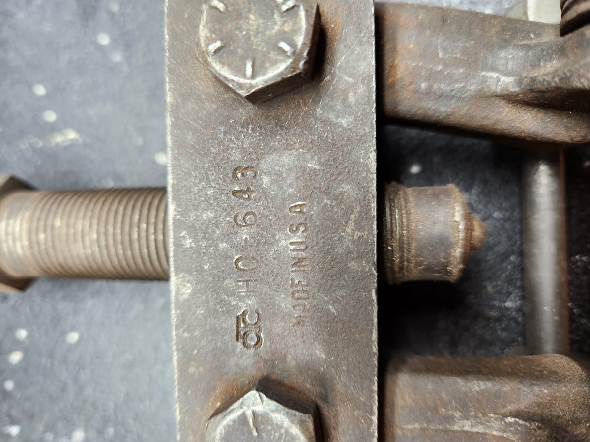

I want to say I've used this one before... but i don't remember any of them being seized in position.

Not even sure exactly the job it's intended or why I bought it.
A quick Google said it's a heavy duty pitman arm puller. So I'm sure i know why I bought it.

You're not gonna believe this one... I got pi**ed and was going through my pile-o-junk tool drawer and found an old wiper arm puller, and I'll be damned if it didn't fit perfectly, like a glove. This thing was stuck but good and it pulled it right off with a wrench.
Man am I glad that worked... I've been a**in with this thing since yesterday. Geez.

Much appreciated. I hope others see this thread, there are a lot of people that have gone though the same thing based on my endless google searches over the past 24 hours, and that $35 dollar tool is the ticket. I don't know how much abuse it could take, but mine was not an easy pull. I had to lay on the wrench pretty good (lot of rust underneath of it) and the tool survived without any damage. It appears to be forged, but it's only meant to pull wiper arms and battery terminals, so it has minimal limits I'm sure. I remember buying this one cuz I was trying to get the wiper arms off of my sons V-Dub and it kept bending the cheap ones.
I can't tell you how happy I am to defeat that thing... it was driving me crazy like that fuel rail line that I never did get loose.
