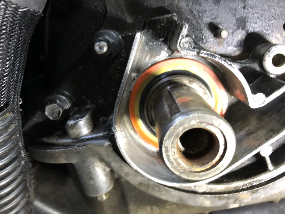

That's fantastic you got the thing off, those pulleys are hard as heck! I've been there on a burnt and rusty pulley, ended up breaking the stock housing and pulling it off if I remember right... I tried everything I had, tried cutting it with a dremel and all sorts of stuff...
If it were me I would pull the front seal housing off and install the seal off the engine, that housing is pretty flimsy, would suck to cause another leak... there's just a paper gasket (can use cereal/beer box to replace) behind it and the rubber oil pan gasket under it so silicone will be your friend...
