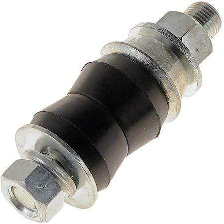

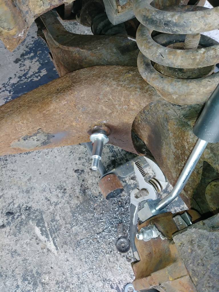

Just like in the video only, way more difficult and time-consuming for old people. The doorman replacement bolt stud really works well it's very heavy and it has a large shoulder to prevent it moving sideways. and I think it's beveled so if someone wanted to weld it it's already set up for that.
So, out of 4 shock absorbers 3 of them were loose, I'm talking rattling loose! hopefully that will make a difference on ride quality,
