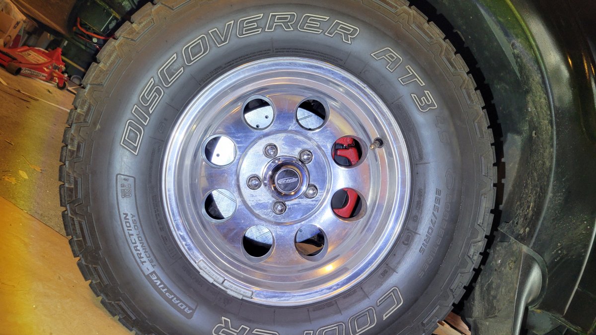

I had to try the new set out, of course. Seat-of-the-pants tells me that I get a much faster stop with less fade.. Some say pads may wear out faster. I really don't care. It's well worth it.
I spent $150 for the disks and pads and another $150.00 for bearings and grease.

And thanks for encouraging me to take on this project. Conventional brakes were just fine, really...all except for those occasional emergency stops when every foot matters. I'm sure these rotors will also help when hauling heavier loads.
Buying an old truck for dirt cheap has enabled me to spend extra money on upgrades and modifications. It's still a Ford Ranger, but now it's a very good Ford Ranger. It handles so much better with that Ford Explorer sway bar, after market shocks, bigger tires, slightly offset wheels, James Duff bars, and that Torsion limited slip.
