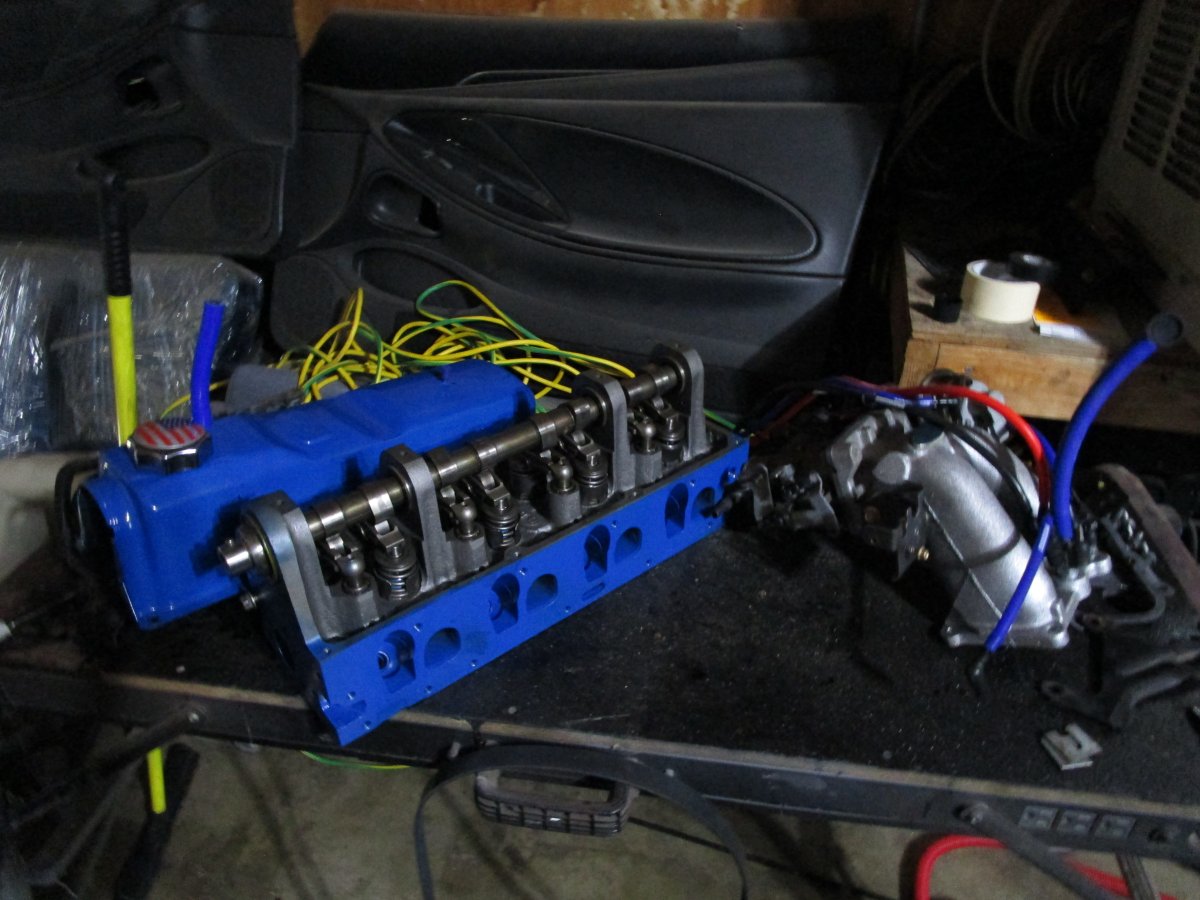

I just rebuilt mine. I kept the original engine. I installed new pistons, rings, bearings and oil pump. I also installed a remain head because mine was cracked between the valves on number 1 cylinder. Mine had 189K miles on it. The original bearings and cylinders still looked good. The main problem that I found was was a clogged oil pick up screen because of a failing oil pan gasket.
  • 1985 Ranger with a tired engine...
