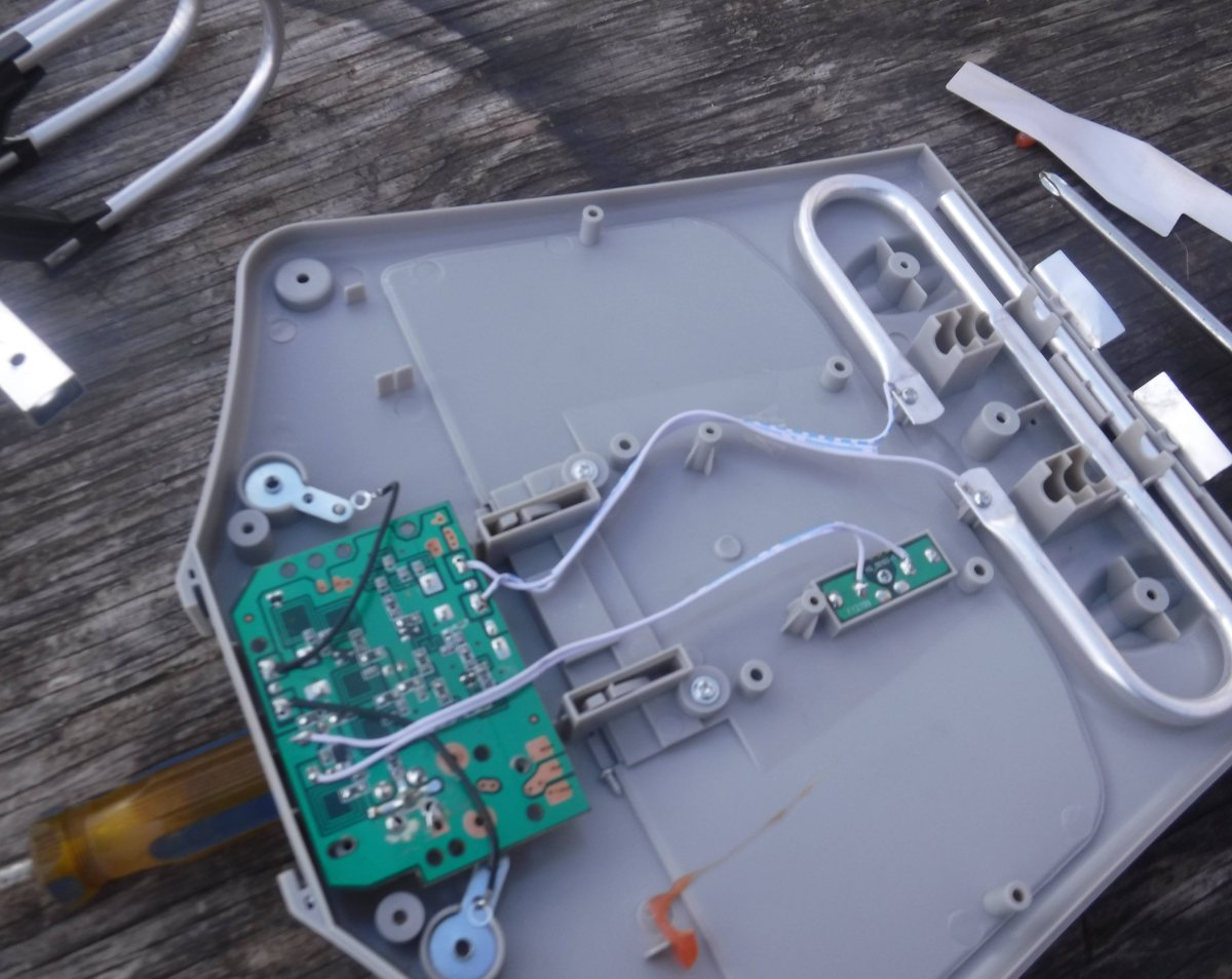

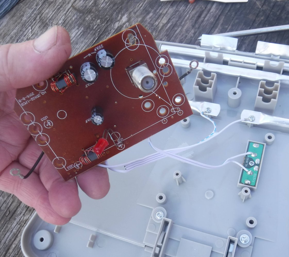

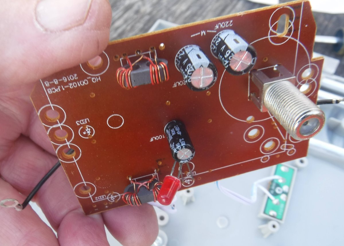

That's it for the electrical part of it. I think it had some boost and a rotate, but it isn't doing me much good now, I'm thinking there's just no signal out there for it to grab.
Does an expanding airport have anything to do with it?

From what is shown that's a UHF only antenna
And the electronics are nothing you need, just something that can break so no more signals
An antenna, of the right size, has no electronics as there is no need, all the electronics are at the other end at the broadcast tower, you just need to collect as much of the signal as possible

That's a folded dipole. They work, but they are a low-gain antenna. They are designed for areas with strong signals. Otherwise, they are junk. Assuming you only have UHF stations in your area, try a panel-reflector (often called bay/bow-tie) antenna is a good option. Yagis and corner-reflectors are better, but require a better aim. If you feel enthusiastic enough about it, there are numerous do-it-yourself instructions on making antennas. You can even make an antenna designed for a specific TV channel.
