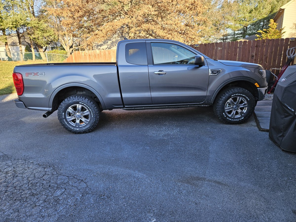

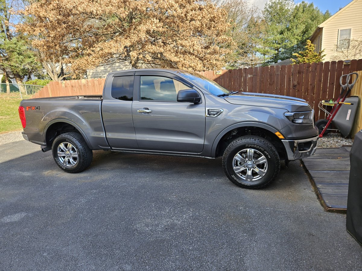

My recently purchased 2021 Ranger XLT SuperCab 4x4 has 265/65/17 tires on it. Will
265/70/17 tires fit without rubbing? Factory "chrome like pvd wheels". FX4 Off Road
package, off road tuned suspension. I noticed yesterday that it sits a bit higher than
a similar Ranger without the FX4 decal. I understand the 70's will alter the speedometer
and odometer slightly, just concerned if they will rub while turning left/right. Thanks.

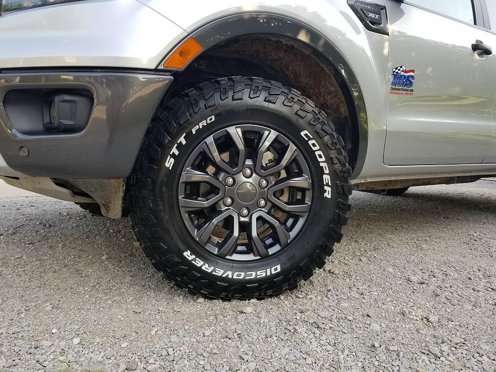

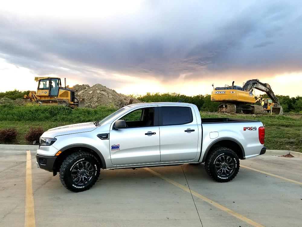

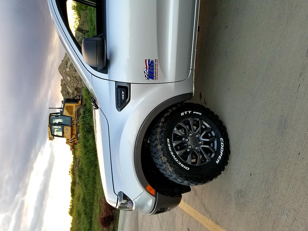

Yes they will......
I have the same tires that Jim shows above and some Falken Wilpeaks. Both fit fine, though there is a bit of mild rubbing at full lock with the mud tires because of the aggressive sidewalls. I can't remember for sure what it rubbed on but it wasn't hurting anything. This is with the stock suspension on a 2019 FX4. The only big differences between it and other 4X4 models, is the rear locker, shocks, and the terrain management system. It didn't get any kind of lift or different rims. So, the fitment will be the same.
