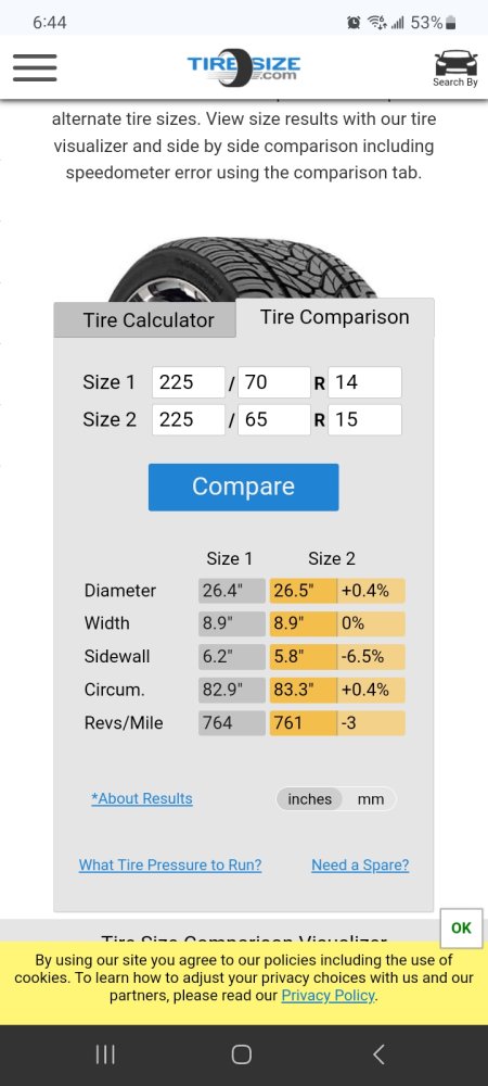

225/65r15 are identical
Tire Size valididation
Well, close enough you won't notice at all
And another very common size

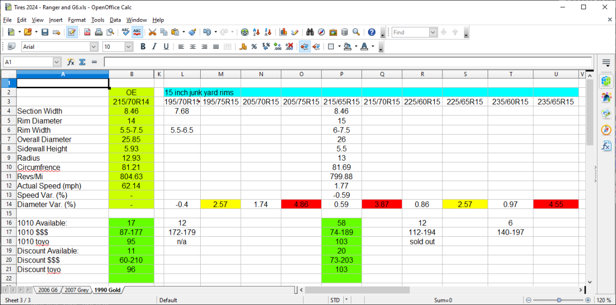

Once I figured out that 215/65/15 was common enough to actually be available and cheap enough I decided to look for that size, and quit filling in the chart. (I ended up getting 16 inch rims so the 16 inch chart is much more filled out.)

1010tires and discount (tires.com) both have +0 size calculators that will suggest what sizes to get based on keeping the speedo/odo accurate. On each of those sites if you click 1 or 2 more clicks you can get a list of what is available, that is how I started filling in that chart.
On your '94 you're a $9 speedo gear away from fixing your speedo if it gets too far off... I got my '97 within 2% that way.
