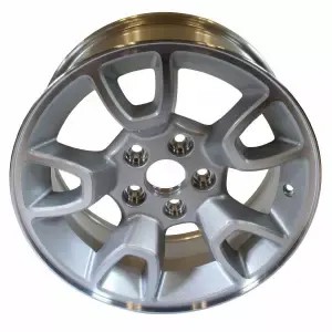

just curious, what rims are those?
The most common are these 16" wheels

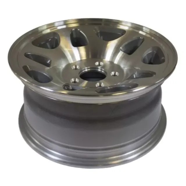

And these 15" wheels
