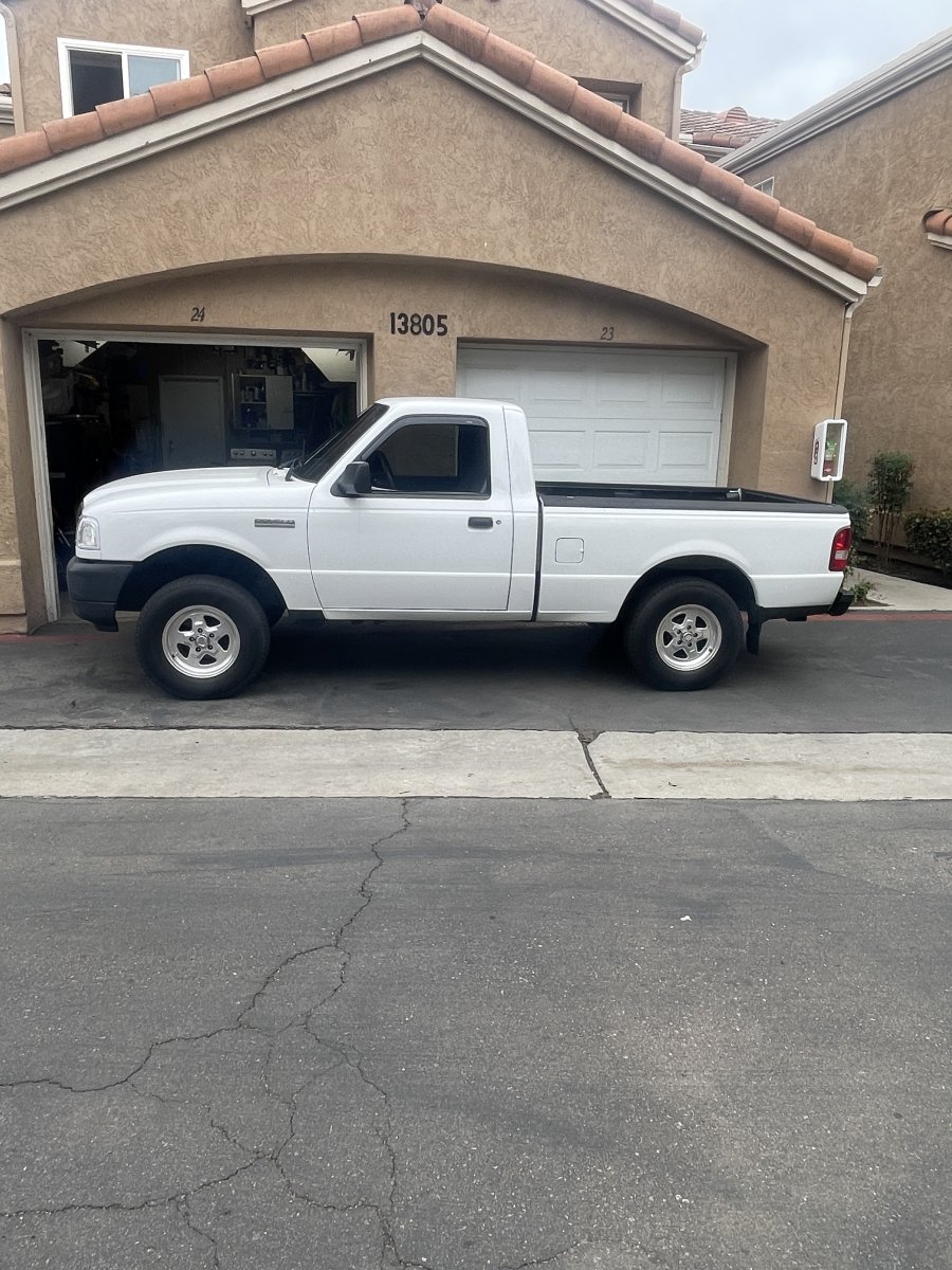

Been chewing on trying to make a decision for a bit, would love some insight that would push me one direction or another....
Truck is 2010 single cab 2wd 4 cylinder ranger.
I installed 4" Wulf spindles in the front only, not touching the back....
This truck will never see the dirt, just my kids first vehicle that will hopefully last him till he gets established...

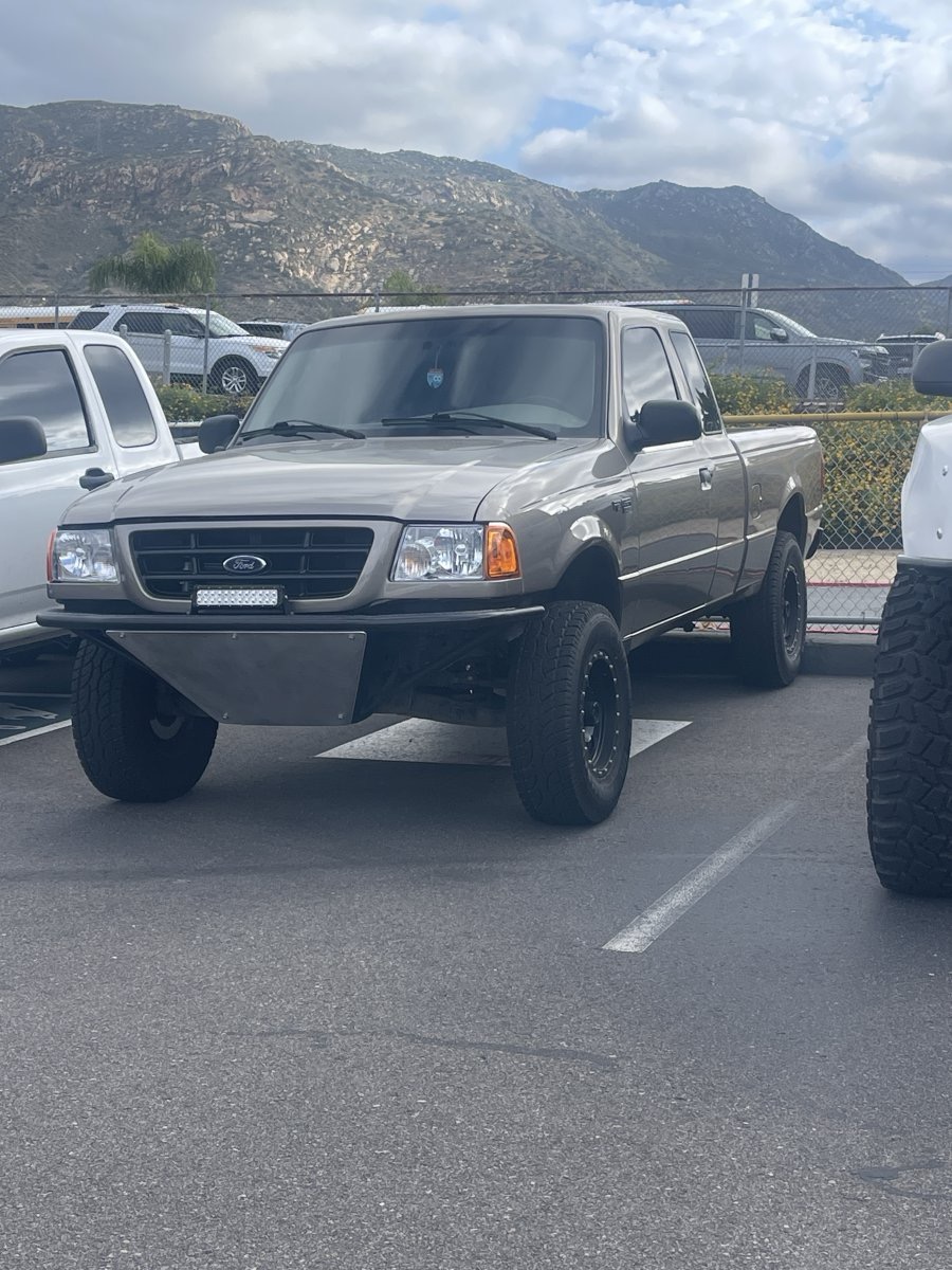

Included a pic of a 2010 ranger with 31 10.5 15
& gray ranger with 30 9.5 15

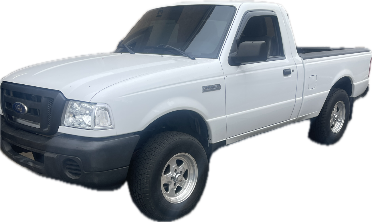

Sons rig after the front spindles....

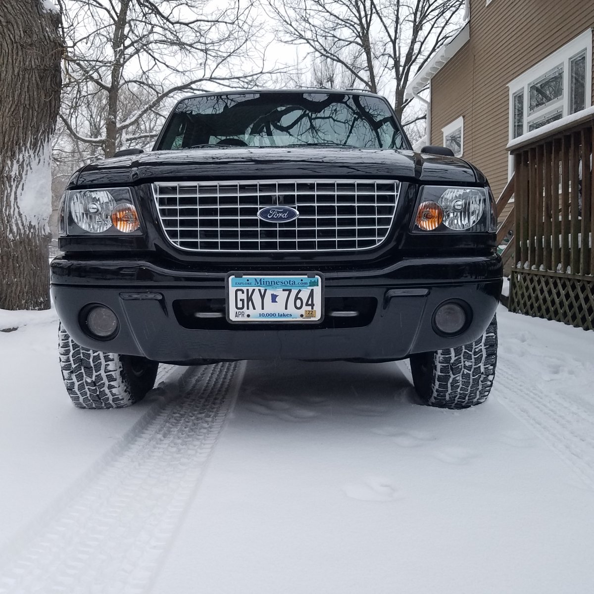

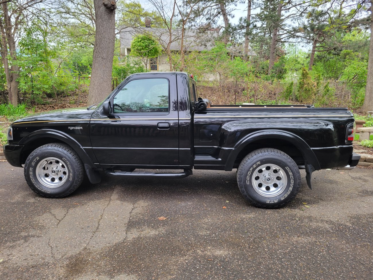

It isn't like I have tried both sizes, but mine are closer to 30. Mine is a 3.0 liter which seems a slittle sluggish. I didn't want to lose any acceleration. I drive it on the street 95% of the time.
Mine is an Edge which came from the factory with a three inch lift. I've changed the suspension and lowered it by one inch...or two inches higher than stock.
tire size 2010 Ranger, 30", 31" ? insight please....
I prefer a wider tire. I believe mine are a little more than ten inches wide.

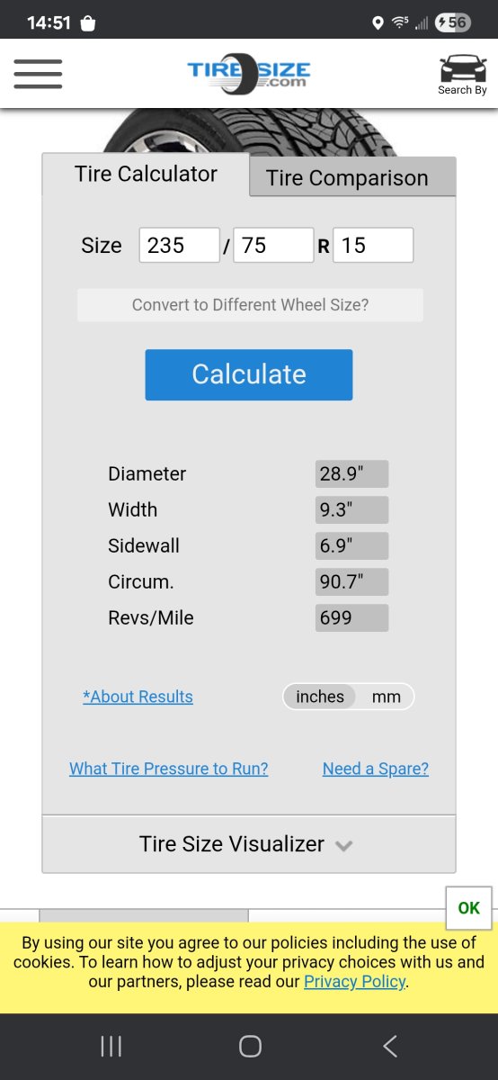

Not sure how size of a 235 75 15 actually compares to a 30 9.5 15...
That tire is about 28.9" in diameter and 9.3" wide.
Check out our tech library where we have articles about tire fitment, pictures of Rangers with different sized tires and even a link to a tire size calculator like I used to get the info in the screenshot. Personally, I wouldn't go above 30" diameter unless you are going to research the axle. Even going to 30" tires, you will notice the truck feeling sluggish, especially with a 4-cylinder.

The gray / copper truck I posted has 30 9.5 15.
Tires look really pinched / narrow?
Maybe not & just my perception, maybe toss a spacer on the front would help....

I saw a stock truck with 235 75 15, & they looked tiny, think theyre even smaller than a 30, calculator states theyre 28.9.....
