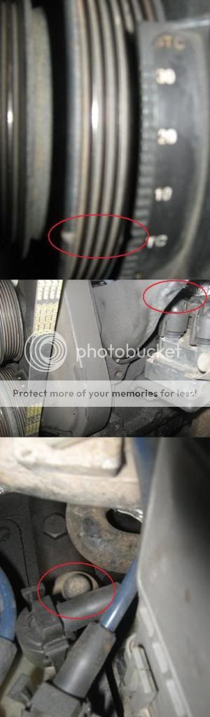

look closer. its a diamond or a triangle. its possible that your 94 doesn't have a cam sensor. look on the side of the engine for something stcking out of the block behind the aux gear. if that dummy shaft has no wires coming out of it then you don't have to worry about the aux gear
also that round peg is not the keyway. put the front timing cover back on and set the pulley mark to the TDC mark of the timing cover and recheck. im going to go get your a picture of my dummy shaft.. mine is the type without a cam sensor

My crankshaft pulley definitely does not have that notched out place, although it does have a very distinct line etched. You can see this in pic 4 of the album as it showed up pretty nice in this picture.

you have to remove the crankshaft pulley to be able to see the keyway. you will have low compression readings if your cam timing is off

Got the crankshaft pulley off and I can distinctly see the "keyway". It is a metal sliver on the crankshaft.
