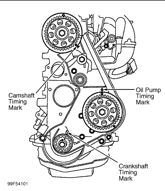

Still no start. Peaked behind timing cover. Oh look, broken timing belt. Replaced timing belt, and tensioner. Marks line up on crank and cam.
Oil pump doesn't need to be timed right?
Turn engine over by hand plenty of times, marks continue to line up every time.

Marks line up to what? I seem to recall that while the oil pump does not need to be timed, it is involved in the timing process. Off the top of my head the cam sprocket index mark needs to be pointed at the oil pump when crank is at TDC.
I could be way off base, I've only looked at the procedure once and it was a year or two ago.
Edit: Yes, the alignment mark on the cam sprocket should be aligned with center tab on the plastic cover, whick also has it pointing directly at the center of the oil pump sprocket. The oil pump sprocket itself does not have a special orientation for timing, but it does drive the distributor (or camshaft synchronizer) so you'll need to make sure that is also aligned with the rest. Assuming that nothing else has been changed, aligning the oil pump sprocket should put the synchronizer where it should be, but still worth verifying.

It is important to note there are two marks on the cam gear, a diamond and a triangle, I think there are at least since the cam and aux gear are the same, ones for lining up the cam and the other the aux shaft, the mark on the inner timing cover should match the shape of the mark... If it's an uneven cranking then something is wrong...

Thanks Josh. It was off a couple teeth. Got it lined up. Seemed like it possibly helped a little. Just got it to start by flooring the gas pedal while cranking. Ran like shit only whole giving it lotsa gas. I would maybe think clogged injectors.. but it doesn't fire off of carb cleaner. So... is it possible for timing to be off 180(does that mean exhaust stroke, not compression stroke) if cam is lined up on center tab pointing to oil pump sprocket, crank is on the money mark, and oil pump is pointing to cam mark also. All timing marks seem perfect..
