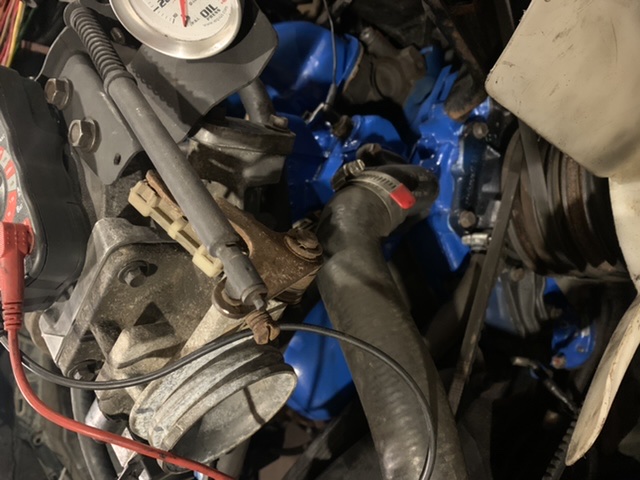

Ok so I tried your test with the IAC, initially it dropped the rpms but let me stress it only did this ONCE. I ran some errands and came back. Now when I unplug it I get no reaction. I put on the old IAC, same result. The plug going to the IAC gets 12.7V KOEO and 14.34V KOER. I also unplugged all vacuum lines except the MAP and the fuel pressure regulator. Both of those lines are new and I have checked are not leaking. about a minute after I unplugged the IAC the most recent time and plugged it back in the engine dropped the rpms so low it stalled itself out. I does seem to do this but it can take minutes for there to be a noticeable effect. The first time earlier today when I did this the rpms dropped immediately after pulling the plug. I have literally swapped the old sensors in, swapped my computers, swapped throttle bodies. I’m at a complete loss here
Codes: 10 and 11c which are a system pass code to my understanding. The engine now timed correctly is sitting anywhere from 1100-1500 and surges to 3000 for a second after starting. At idle the timing roams from 20 roughly to 27 seeming randomly. Sorry for the formatting of this post, I’m writing this from my phone
One other thing, the screw your talking about. Is it located on the throttle body right next to where the throttle linkage clips in? If so I have this all the way out to where it is barely touching the plate on the linkage

Yes that could be the anti-diesel screw, it sets minimum throttle plate opening
Make sure throttle plate is not loose
